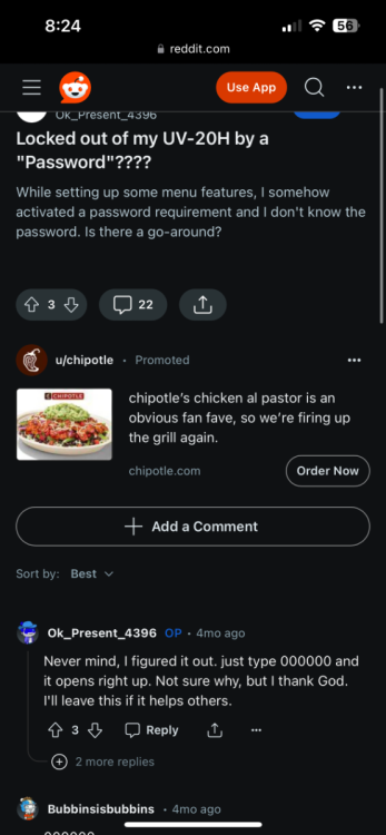

SteveShannon Posted May 16 Report Share Posted May 16 I found this on Reddit. A person accidentally enabled the password without actually setting it. It turned out that the default was 000000: RayP and WRXB215 2 Quote Link to comment Share on other sites More sharing options...
