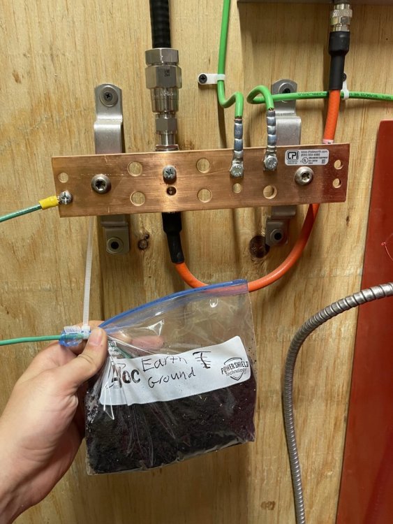

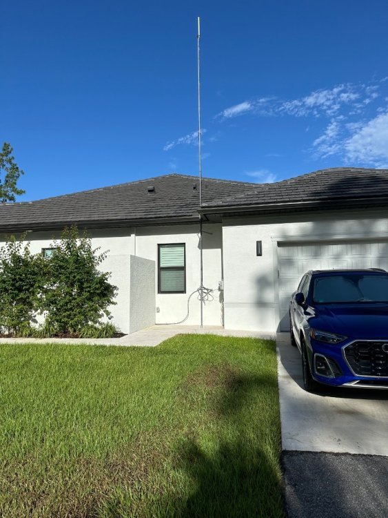

0 WSBT338 Posted July 20 Report Share Posted July 20 Thanks for the advice to you both. I not only upgraded my mast ground wire to 6AWG, I also stepped up the coax to LMR400 (from RG8X). It took two 25’ cables to reach from my antenna to my repeater which is in the bedroom on the other side of the wall. I put the lightening arrestor between. That and the mast are attached to the ground rod. Am I good? WRXP381 and WRUU653 1 1 Quote Link to comment Share on other sites More sharing options...

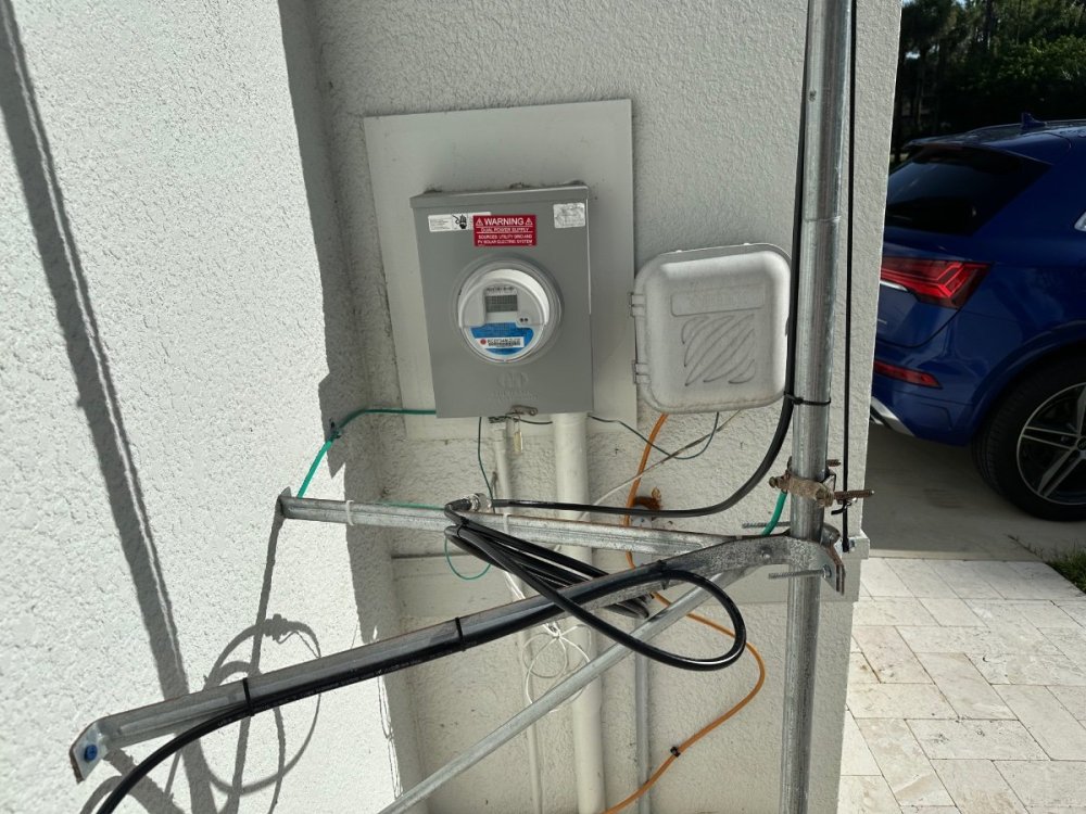

0 WSBT338 Posted July 22 Report Share Posted July 22 29 minutes ago, back4more70 said: I can appreciate all of these questions, but does no one ever hire an electrician? I did. But he just did what I asked him to do. I guess the only thing outside of his scope was where I put the lightening arrestor - which was really the only place I could put it without splicing one of the 25’ coax. He did a great job. Guess I was just showing off a bit, too. Love how it turned out. I can reach my entire neighborhood now and have a B-Tech RPT50 Repeater inside. The mess in my close-up photo that consists of the orange and black wires (with white paint) aren’t on me. That’s Comcast I think Quote Link to comment Share on other sites More sharing options...
0 WRUU653 Posted July 22 Report Share Posted July 22 On 7/20/2024 at 6:08 AM, WSBT338 said: I don’t want to be negative here but your electrician may want to familiarize themselves with the electrical code section 110.26 Spaces About Electrical Equipment. Particularly the section and tables on working clearances. Your local utilities company also will have rules. WSBT338 and SteveShannon 2 Quote Link to comment Share on other sites More sharing options...
