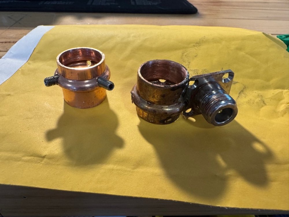

WRUE951 Posted December 30, 2024 Report Posted December 30, 2024 i have both versions of the J-Pole, both home brew and favor the Copper J-Pole over the Twin Wire J-Pole.. I use the copper j-pole for a portable repeater while camping. Getting the SWR's to perfection on the Copper J-Pole is a major PITA so i came up with a method for adjustability (see pics). Not shown in the attached picture, i had to grind down 1/2 inch on one side on each of the adjusters. The adjusters are made from a modified crimp on copper splice (Home Depot) and removing the internal rubber gaskets, cutting the splice in half then tapping for the set screws. It works great, i'm able to get 1:2 - 1:3 on my repeater channels (18)... The Copper J-Pole has talked roughly 90 miles, I've gotten about 60 with the Twin Lead version.. Both better than my home Base Laird FG-4607 and i can't figure out why on that one.. AdmiralCochrane and SteveShannon 2 Quote
