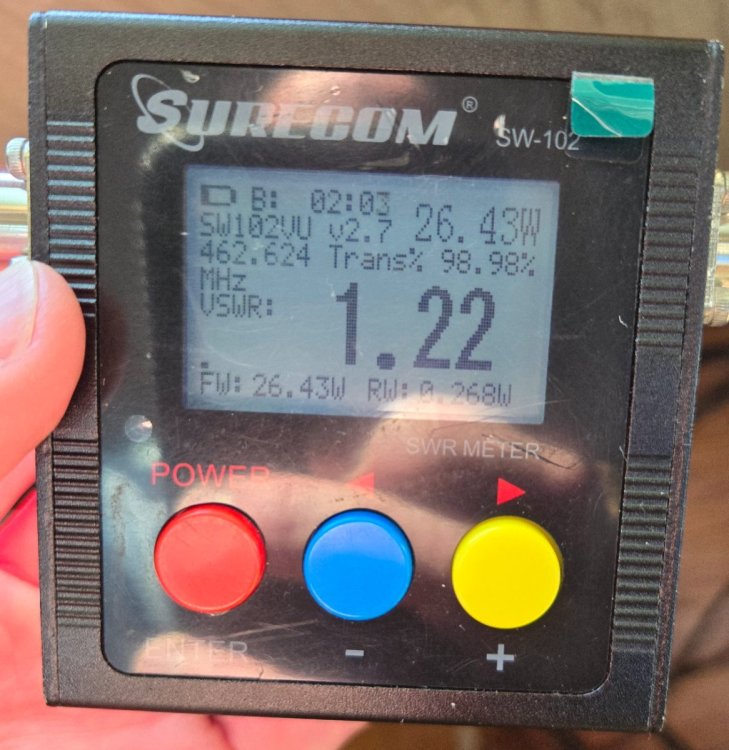

I have the nifty Surecom SWR meter and thought I'd run the antenna to the antenna side of the meter and the jumper to the TX side of the repeater.   I then key an HT to activate the repeater but the swr meter does not read.
So NOW what is this grade school level repeater owner doing wrong?

I plan to have someone with the right equipment tune the duplexer.   What I was wondering was if I could connect my cheap Chinese Surecom SWR meter to read the TX power and SWR.
What I did notice is I get transit and receive with the courtesy beep but could not make out any voice on either radio.   It was just static and the courtesy beep.
Could this be due to the duplexer being out of tune?

So i figured out why the Surecom SWR meter wasn't reading anything.   The internal duplexer was hooked up to the RX connector on the back of the repeater.   So next time I'll open the case.
So now the repeater works,  a bit off freq and surprised by the lower TX power.  Is that typical after the duplexer for a 40 watt Vertex?
