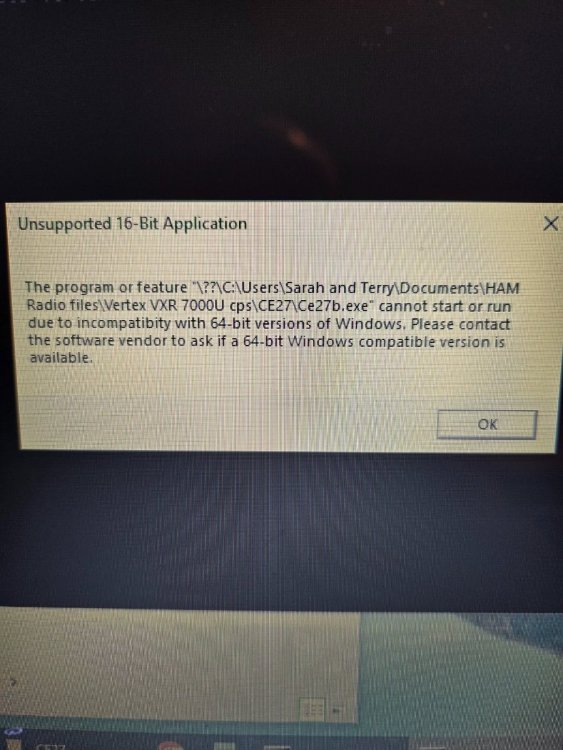

I got my programming cable over the weekend.  I have both CE27 and CE59 CPS but when I try to open them with Windows 10 Home it says it's not compatible with 64 bit Windows.  It's strange how some people can get it to work on 64 bit Windows 10 but I am unable.  Anyone else had this happen?  I then installed the CPS on a Windows 8 machine and had the same "can't run on 64 bit" message.  Any suggestions on what else I can try before I go looking for a Windows 7 32 bit laptop?
Maybe I need to have the programming cable hooked up to the repeater BEFORE I try opening the CPS?  Or should I be able to open it without being attached to the repeater?

Did you try right clicking on the executable and selecting “run in compatibility mode”?
Also, you can type alt+prt SCR or ctrl+prt SCR to take screenshots rather than using a camera.
I am running CE27 V1.08 for Windows on a Windows 10 Home (22H2) .. I have it set to run in "Windows 7" Compatibility mode and it runs fine.
