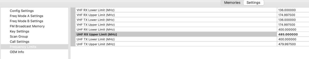

I'm trying to set up my 935 to receive a few surrounding town public safety frequencies. One of them falls beyond the specified limit in the manual (Receive (RX) Frequency Range: 136-174.995 MHz 400-479.995 MH). The frequency I need to program is 484.400. I noticed in CHIRP there is a section called "Frequency Limit" that appears to be adjustable. Can I adjust the upper frequency of the 935 in CHIRP without risking damage to the radio, and am I running afoul of the FCC given that radio was certified (or whatever the term is) at the specified frequency range?

Before I asked the question I programmed channel 999 with 484.400 via CHIRP (before I realized the frequency limits). After the settings were uploaded I looked at the Channel 999 in Frequency mode and the frequency displayed was 400.0250, so there appears to be some automatic reset of the frequency if the programmed frequency exceeds that for which the radio is specified.

I just attempted to enter 484.400 via the keypad and same result, I got a double beep and a reset to 400.0250.
1 hour ago, numnutz6383 said:
...so there appears to be some automatic reset of the frequency if the programmed frequency exceeds that for which the radio is specified.
The OEM software behaves the same.
38 minutes ago, WRXP381 said:
I would have just tried to expand the range and chirp and see how it went.
I'll try in CHIRP, I just wanted to confirm no damage to the radio could occur.
Have you had a chance to try it yet?
Negative, haven't had a chance yet. I emailed buytwowayradios.com to get their opinion and received the following reply:
"It's hard to say conclusively as that is very close to the factory limit. It's unlikely that the radio will be damaged merely by receiving a transmission. More often than not transmitting on bands the radio is not built for will either just not work, or work badly and damage the unit. I do want you to be aware though that using the radio on bands it's not rated for will void the warranty."
Which is essentially what the replies I received here are.

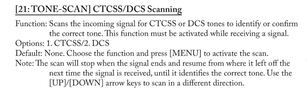

Does the 935 have the ability to scan a nearby transmitting radios frequency and privacy code? Like the UV-5G Plus "one touch" button feature, or holding down "1" on a td-h3?
Yes for tones, But it’s not one touch.
54 minutes ago, OffRoaderX said:
Which is not even remotely close to what he asked if it could do.
Perhaps I misunderstood what he was asking. I have been a bit punchy today from consuming cough syrup so… 🤷‍♂️
