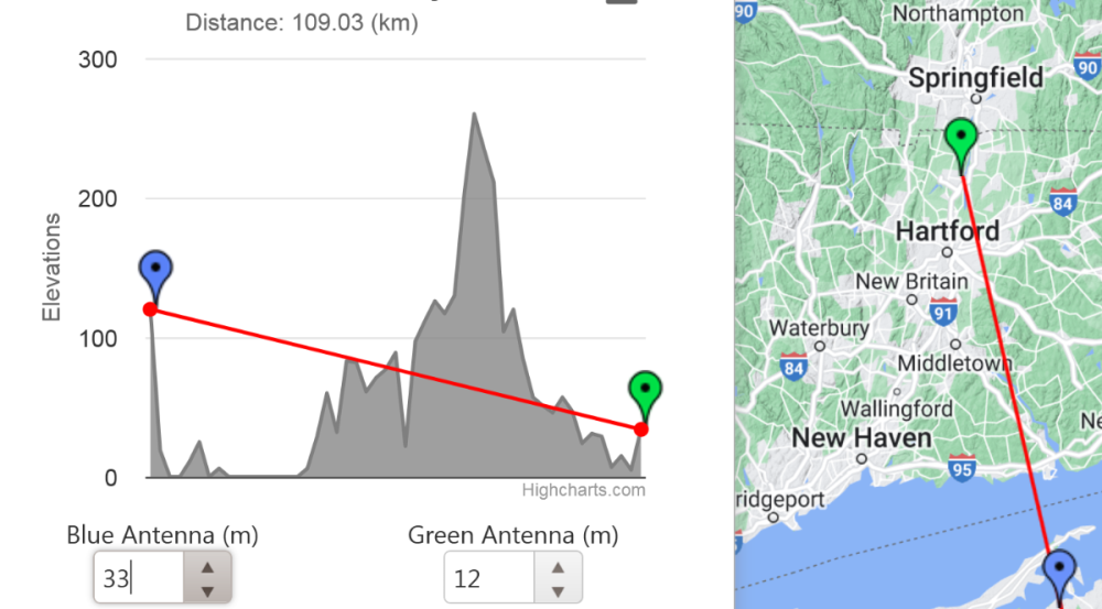

LeoG Posted July 29, 2024 Report Posted July 29, 2024 I'm receiving a signal from the 575 LI East End repeater in Northern CT when I clearly should not be able to receive or hit this repeater, which I can. I've noticed the low level signal on my radio which is set to a much more local repeater. I figured out what the output PL tone was to isolate it and listened in. Figured out the PL input and was able to hit it. Right through a mountain, unless their antenna is 590 meters above ground level. Not sure if this is something I can receive/hit regularly or not. Quote
