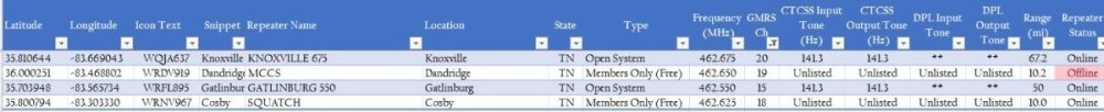

Basically Sevierville, TN. Decent repeater coverage but somehow two very powerful repeaters on line of sight mountaintops got shared tones and frequencies. One of them has strong audio and near instantaneous propagation, the other has weak audio (strong signal) and a slight delay on propagation. This lead to very garbled transmissions when they both picked up a signal and rebroadcast it. It actually took me 2 days to figure out what was wrong as prior commenters had also mentioned garbled audio. Pulled out the trusty SDRs and a couple of antennas and went hunting for interference. Only after I found an unexpected second repeater did I cross-reference MyGMRS and found it, updated 2 days ago.
I found some other interesting things that I wasn't expecting, like someone running a Pirate DMR in apparently simplex (encrypted, no less!) on 467.725 in the nearby area.
