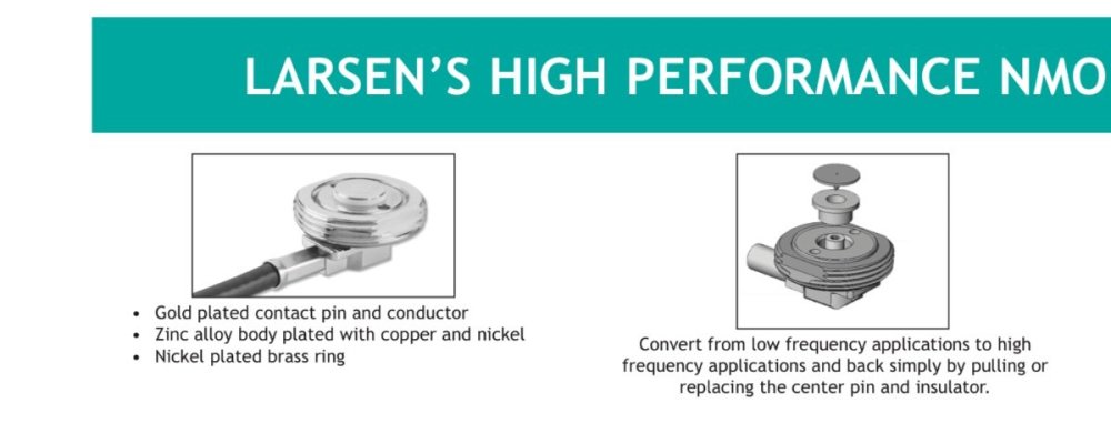

SteveShannon Posted January 15 Report Posted January 15 25 minutes ago, gortex2 said: Larsen NMOKHFCX is probably the best mount out there right now. Any Larsen, Laird, PCTEL, Motorola mounts are good. It’s probably just one of my own biases, but every time I consider the Larsen mount I shy away from their use of zinc alloy. Quote

tcp2525 Posted January 15 Report Posted January 15 38 minutes ago, SteveShannon said: It’s probably just one of my own biases, but every time I consider the Larsen mount I shy away from their use of zinc alloy. Maybe you are confusing Chinese "pot metal" with quality brass that is alloyed with zinc? I can assure those mounts are quality, definitely from a metallurgical perspective. gortex2 1 Quote
SteveShannon Posted January 15 Report Posted January 15 Just now, tcp2525 said: Maybe you are confusing Chinese "pot metal" with quality brass that is alloyed with zinc? I can assure those mounts are quality, definitely from a metallurgical perspective. Nope, it has nothing to do with China. I’m thinking of Zamak and its past usage in machinery. The specifications for this mount specify copper, brass, and zinc alloy separately. Quote

tcp2525 Posted January 15 Report Posted January 15 20 minutes ago, SteveShannon said: Nope, it has nothing to do with China. I’m thinking of Zamak and its past usage in machinery. The specifications for this mount specify copper, brass, and zinc alloy separately. Brass is, at least yellow brass is 34% zinc mixed with copper. The nickel comes in as plating. Scrap the nickel and you will see yellow brass. Quote

SteveShannon Posted January 16 Report Posted January 16 On 1/15/2025 at 9:25 AM, tcp2525 said: Brass is, at least yellow brass is 34% zinc mixed with copper. The nickel comes in as plating. Scrap the nickel and you will see yellow brass. While that’s all true, I’ve never seen someone refer to a brass component as “zinc alloy”. Brass is an alloy of copper and zinc, not a “zinc alloy”. If you think there’s no difference, go to a nearby scrapyard and ask what the difference is. Clean die cast zinc alloy scrap goes for just over $0.50/lb. where yellow brass is about $2.30 and red brass is nearly $3. This portion of a picture from Larsen makes it even clearer that the main body is a zinc alloy component which has been copper plated and then nickel plated (not a brass component). They understand the difference because they refer to the ring as brass. Does that make it substandard? Absolutely not, but as I said earlier, I have a personal (derived from my earlier bias towards zinc alloy frames used in cheap firearms and some machine tools) bias against zinc alloy components, especially when other materials are available. I have an old Atlas lathe that has Zamak change gears. There’s just something about zinc alloy that screams “cheap” to me. Laird, however makes a very similar NMO mount that is all brass. https://theantennafarm.com/shop-by-categories/antennas-mounts/mobile-antenna-mounts/nmo-mobile-antenna-mounts/266-permanent-hole-mounts/289-nmo-3-4-hole-mount-no-connector/1140-laird-connectivity-mb8-detail Based on @gortex2’s recommendation I might still get the Larsen, although I doubt I’ll need the additional 5 GHz of range. WRUU653 1 Quote

Hoppyjr Posted January 16 Report Posted January 16 I’ll add this….When I did my install I used “regular” NMO mounts through the roof. I’m running one for the Icom 2730 and one for the Wilson WeBoost. As I looked at other antenna options, specifically for the WeBoost, I found some antennas that would work, but require high frequency style connections at the antenna. In doing basic research, I found mounts that were compatible with both regular low frequency use and high frequency, by simply removing a center pin. If I were doing my install today, I’d use these as they’d allow more options down the road. Here are photos to illustrate. I’ll also attach a link for example purposes (I’m not promoting the vendor). https://www.arcantenna.com/products/pulse-nmokhfud-nmo-hi-frequency-mount-17-foot-rg-58u-dual-shield-cable-no-connector?srsltid=AfmBOopB869pI27iizHPQ8dF6v0K9-VrFHQVV596PYj5Laz_-tkvAuh0 Quote
tcp2525 Posted January 16 Report Posted January 16 5 hours ago, SteveShannon said: While that’s all true, I’ve never seen someone refer to a brass component as “zinc alloy”. Brass is an alloy of copper and zinc, not a “zinc alloy”. If you think there’s no difference, go to a nearby scrapyard and ask what the difference is. Clean die cast zinc alloy scrap goes for just over $0.50/lb. where yellow brass is about $2.30 and red brass is nearly $3. This portion of a picture from Larsen makes it even clearer that the main body is a zinc alloy component which has been copper plated and then nickel plated (not a brass component). They understand the difference because they refer to the ring as brass. Does that make it substandard? Absolutely not, but as I said earlier, I have a personal (derived from my earlier bias towards zinc alloy frames used in cheap firearms and some machine tools) bias against zinc alloy components, especially when other materials are available. I have an old Atlas lathe that has Zamak change gears. There’s just something about zinc alloy that screams “cheap” to me. Laird, however makes a very similar NMO mount that is all brass. https://theantennafarm.com/shop-by-categories/antennas-mounts/mobile-antenna-mounts/nmo-mobile-antenna-mounts/266-permanent-hole-mounts/289-nmo-3-4-hole-mount-no-connector/1140-laird-connectivity-mb8-detail Based on @gortex2’s recommendation I might still get the Larsen, although I doubt I’ll need the additional 5 GHz of range. Thank you for posting a more concise description of what this thing is really made out of. The link @gortex2 posted wasn't as descriptive and had me assuming, and you know what they say about assuming, that it is that fancy new marketing speak that's so prevalent these days. They didn't even mention plating. This reminds me of going to Home Depot to buy a garden hose with "copper infused" fittings, which simply means anodized aluminum that is colored to look like copper or brass. And yes, I do know what these differences are when it comes to metallurgy. I'm just not proficient posting from a smartphone. Yes, brass is made by alloying copper and zinc. Also, pure zinc or magnesium is used in sacrificial anodes in the corrosion prevention sector. And now that I see that they are using "zinc alloy" which indicates it's not pure zinc, not that it matters in this application. The primary reason these NMO mounts are being manufactured with "zinc" is it's much cheaper than brass, as you indicated. And requires very little machining, if any, as these mounts are die-cast. In my opinion, these are equivalent to Chinese pot metal. That said, I'm confident these mounts are still going to be quality from an electrical and mechanical perspective and one shouldn't have any second thoughts of using one. Call me old fashioned as I've been using quality brass NMO mounting kits for close to 40 years. Plus, I have a nice stockpile of kits to last me two lifetimes. No zinc for me. SteveShannon and WRUU653 1 1 Quote
