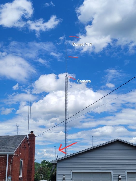

Flameout Posted January 21 Report Posted January 21 I made a PVC type "hanger" for my slim jim. Was supposed to be temporary, but it's been there for over a year now. It's the arrow in the photo (sorry, it's the only photo I had available, but you can see what I mean) WSFL951 and warthog74 2 Quote
