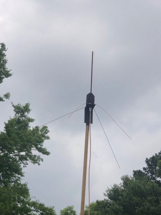

I made a 2 meter ground plane from doubled up solid #12 wire. Worked well, but bent easily, even doubled and soldered for the entire lengths. Birds kept bending the radials down. I'm using it indoors for an SDR receiver and it does fine for broadcast FM and up.
@HHD1: A VHF/UHF ground plane is extremely easy to make using an SO239 bulkhead connector and pieces of copper wire. I think mine cost me about $8 to put together.
