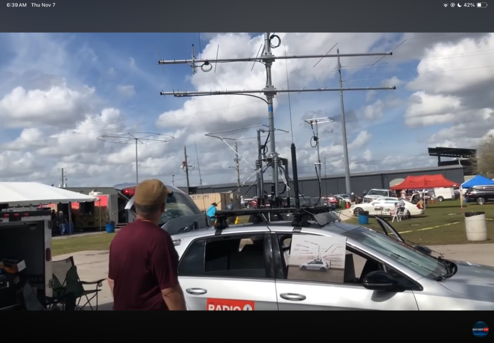

6 minutes ago, Lscott said:
This guy has a few more.
I imagine every hair on my head would stand straight up if I keyed up in that thing...
