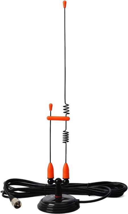

My circumstances are on a 2024 Bronco Sport and I was looking at this antenna.
 Amazon.com: HYS Amateur Dual-Band VHF & UHF Magnet Base Antenna for 2m/70cm Motorola Mobile Ham Radios & Repeaters with 3.5inchs Magnetic Mount, W/13ft RG58 Cable PL-259 UHF Male Mag Mount (Black) : Electronics
What are your thoughts.

I wouldn’t use that antenna for GMRS.  If you really need an antenna that’s good for GMRS the mxta26 from Midland is very good. If you need an antenna that’ll handle both ham and GMRS the Comet 2x4 is what I would get.
I’m honestly trying to understand what this Hys antenna is supposed to be.  It looks like it might want to be a j-pole but the feed isn’t right.

It's supposed to be dual band, according to the description.  136-174Mhz&400-470Mhz  Is that an impossibility? Asking for the noob I see in the mirror. :)
No, that's not impossible but that antenna looks like a gimmick.  There are a lot of dual band antennas with narrower bandwidth.  The Comet CA-2x4SRNMO is a commercial quality antenna that advertises SWR under 2.0:1 from 140-160MHz / 435-465MHz:  https://www.dxengineering.com/parts/cma-ca-2x4srnmo?ppckw=dxedsa-br-comet-antennas&gclid=CjwKCAiAlPu9BhAjEiwA5NDSA391BAQ5nheA3lTesm2uL_RtcAxEGeTVdPk02M-JzNlz8vamfTEcAhoCnZgQAvD_BwE#overview

Not impossible, but improbable. Stico has one similar, but it's a bit more narrow banded, and made much better. https://sti-co.com/magnetic-flexi-whip-tri-band-antenna/
