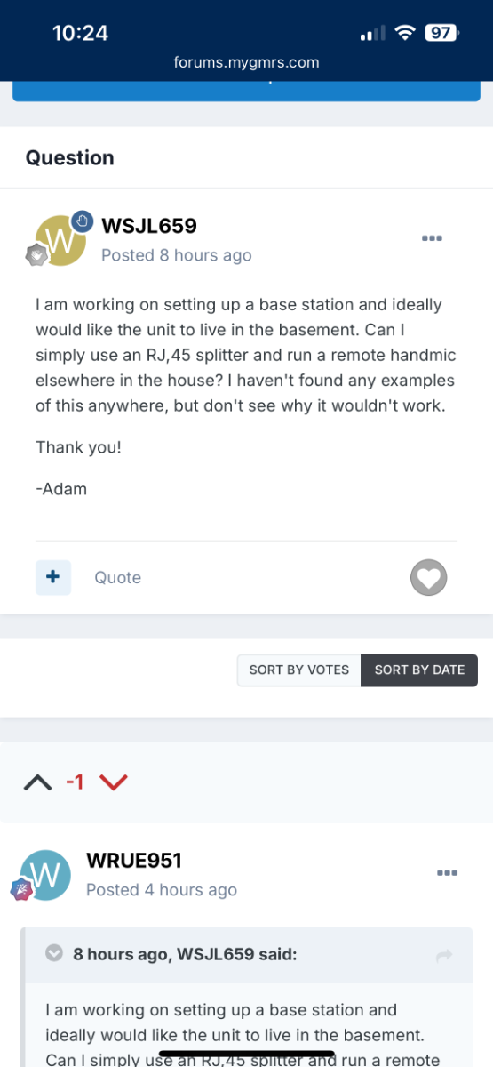

I am working on setting up a base station and ideally would like the unit to live in the basement. Can I simply use an RJ,45 splitter and run a remote handmic elsewhere in the house? I haven't found any examples of this anywhere, but don't see why it wouldn't work. Thank you! -Adam
