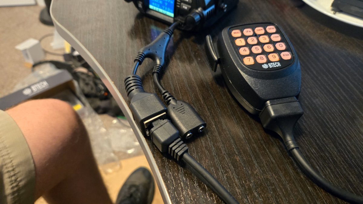

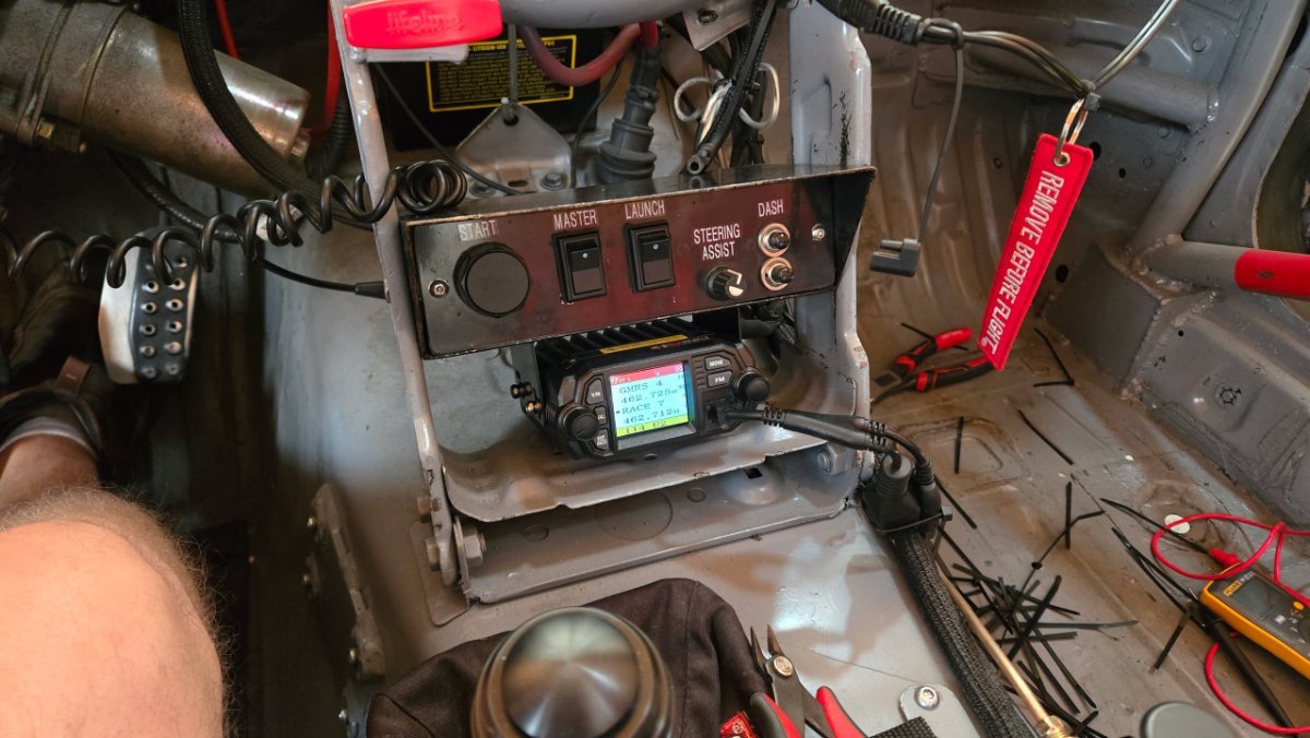

To answer the original question: I don't see a reason that wouldn't work. There's a couple of BTech radios that do this from the factory. They have RJ-45 connectors at the radio, and come with a splitter that has RJ-45 on 1 end, and a K1 connector on the other. In my case, I have one in my race car, with the K1 connector going to the wiring harness for my helmet mounted mic & ear buds, and steering wheel mounted PTT. -

It's basically* ethernet in the same way that the 120v wiring in your house is basically ethernet. Ethernet is a network technology. There's no 'networking' going on between the mic and your radio. No addressing being shared. It's just using a common connector to pass the same type of signal (your audio, your PTT trigger, button pushes) that would come through any other kind of mic connector to the radio. It's an RJ-45 connector. It's nothing at all like an ethernet connection other than it shares a common connector type. -

Two problems I see... 1st) If you are using a Y-cable/splitter I'd assume you are going to run into mic impedance issues. The radio is designed for a certain microphone impedance, adding another mic in parallel or trying to extend the cable by 30ft is probably gonna jack it up. 2nd) If you did run a 2nd hand mic somewhere - what about audio? -

No, although the same connector is used, none of the radio microphones for which I’ve seen schematics are Ethernet. The different wires carry analog audio, push to talk, and other analog connections which allow push buttons or LED lights on the microphone. -

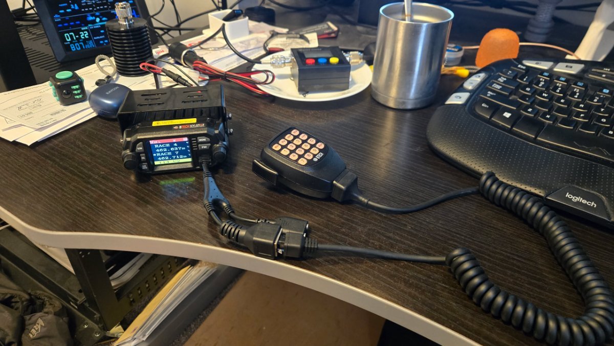

Some people do use an RJ45 manual switch to switch between two microphones, but in that case only one microphone is connected at a time. I don’t know how what you refer to as an RJ45 splitter is actually wired, but if the two microphones are connected in parallel I would not expect good results. Also, there’s the problem of having a long run for the microphone cable. You might find that it’s just too long and your audio signals are too weak. -

I am working on setting up a base station and ideally would like the unit to live in the basement. Can I simply use an RJ,45 splitter and run a remote handmic elsewhere in the house? I haven't found any examples of this anywhere, but don't see why it wouldn't work. Thank you! -Adam
