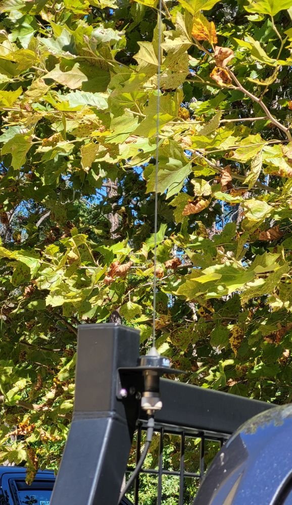

I have an aluminum 2020 F-150 and mounted a 2meter and GMRS antenna on each side of the 'BackRack'. Works OK, but not quite as well as the NMO in the center of my 2012's steel roof.
Here's the 2 meter side - the other side is jammed into the tree and almost invisible.
