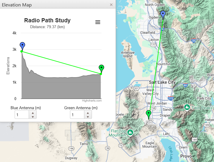

dosw Posted October 31, 2025 Posted October 31, 2025 It depends. It's uncommon. It's not impossible. Let's assume the repeater's antenna is 200 feet above the prevailing elevation. And you are standing 5 feet above. In that case, one would expect, if there are no obstructions between, for the rante to be about 23 miles (20 miles for the 200 foot repeater, 3 miles for you at 5 feet). This is because, beyond 23 miles, the curvature of the earth becomes the obstruction between you. For there to be 60 miles of range, with you at 5 feet off the ground, the repeater's antenna would need to be 1800 feet above the terrain between you two. In a mountainous area, this is possible. As an example, I live at 5000 feet. The valley floor below is at 4200 feet. There is a repeater 57 miles away at 6500 feet. We can communicate easily, because for practical purposes I'm at 800 feet, and the repeater is at 1500 feet. We can communicate because the curvature of the earth does not interfere between us, nor are there other significant obstructions. We could actually be 94 miles apart and it would still be amost okay. So if you and the repeater you're talking about are on opposing hillsides or hilltops, and there's nothing between you, it's possible. If you don't have a combined total of about 1805 feet above the ground between you, you probably can't. amaff and Raybestos 2 Quote
WRKC935 Posted November 1, 2025 Posted November 1, 2025 On 10/31/2025 at 5:13 PM, dosw said: It depends. It's uncommon. It's not impossible. Let's assume the repeater's antenna is 200 feet above the prevailing elevation. And you are standing 5 feet above. In that case, one would expect, if there are no obstructions between, for the rante to be about 23 miles (20 miles for the 200 foot repeater, 3 miles for you at 5 feet). This is because, beyond 23 miles, the curvature of the earth becomes the obstruction between you. For there to be 60 miles of range, with you at 5 feet off the ground, the repeater's antenna would need to be 1800 feet above the terrain between you two. In a mountainous area, this is possible. As an example, I live at 5000 feet. The valley floor below is at 4200 feet. There is a repeater 57 miles away at 6500 feet. We can communicate easily, because for practical purposes I'm at 800 feet, and the repeater is at 1500 feet. We can communicate because the curvature of the earth does not interfere between us, nor are there other significant obstructions. We could actually be 94 miles apart and it would still be amost okay. So if you and the repeater you're talking about are on opposing hillsides or hilltops, and there's nothing between you, it's possible. If you don't have a combined total of about 1805 feet above the ground between you, you probably can't. removed Quote
