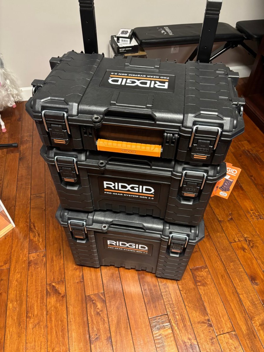

Build it into a Rigid box (the top one on the stack):
One of the lower boxes will house a 100 Ah portable battery set-up with solar and DC-DC charging, and will primarily live in a vehicle and serve as both an aux battery and a deployable mobile power source. But that's a build for a different forum! In any event, it will power the repeater when the repeater is mobile.

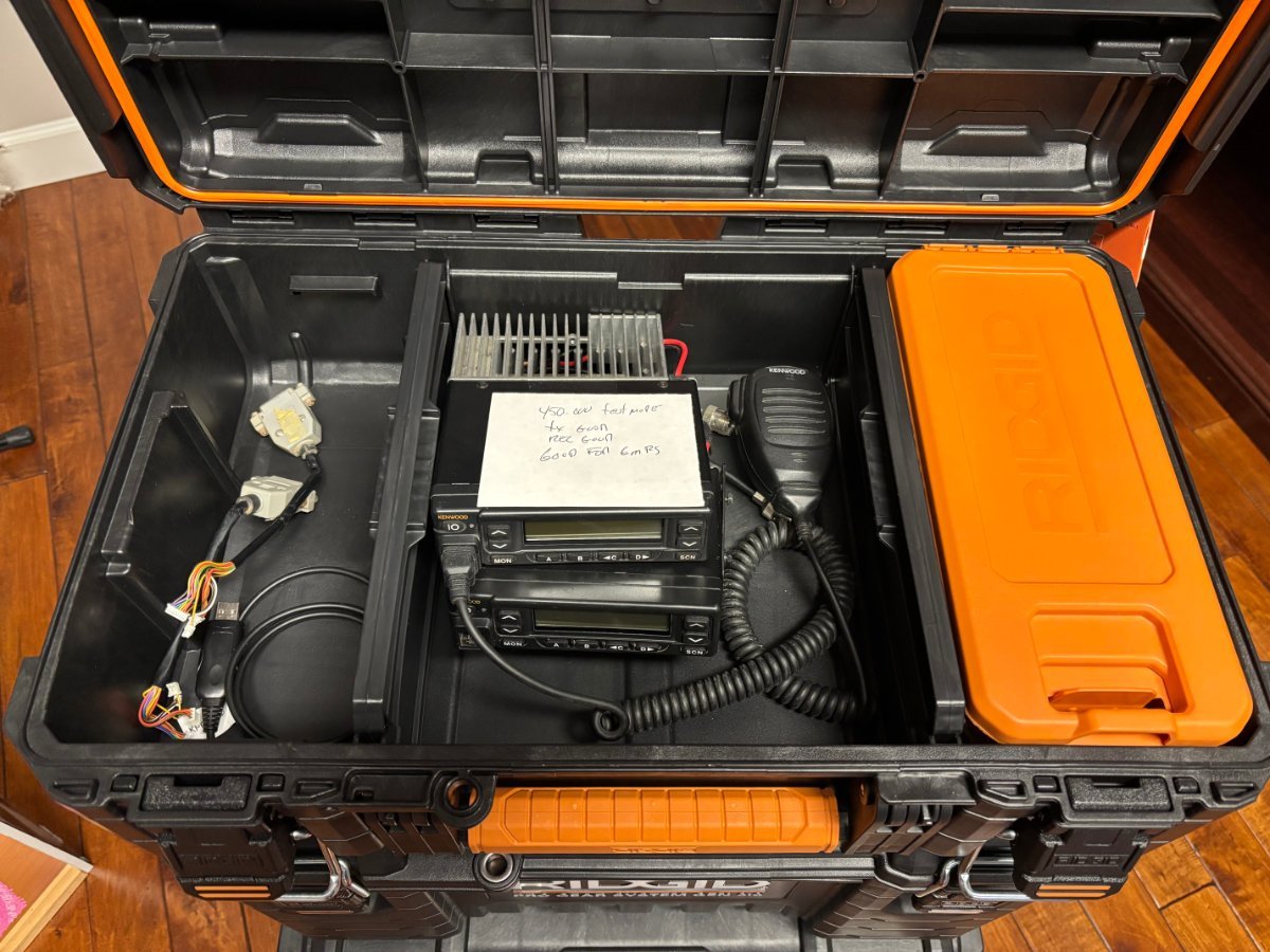

Repeater components (✅ = have already)
  • ✅ TK-880H Tx radio (with mic)
  • ✅ TK-880 Rx radio
  • ✅ RFS 633-6A-2N duplexer
  • ✅ (2) KCT-19 cables (for repeater controller integration)
  • Repeater controller (model TBD)
  • Cooling/ventilation fan
  • Bulkhead connectors:
    • 12V power (Anderson Power Pole)
    • Antenna (N-female / N-female)
    • RG-45 (if using PI-REPEATER)
  • ✅ Ed Fong GMRS antenna
  • 20-25' telescoping mast (painter's pole & guy lines?)
  • Antenna feed coax (LMR-400-UF?)
  • Internal connection cables (LMR-240?)

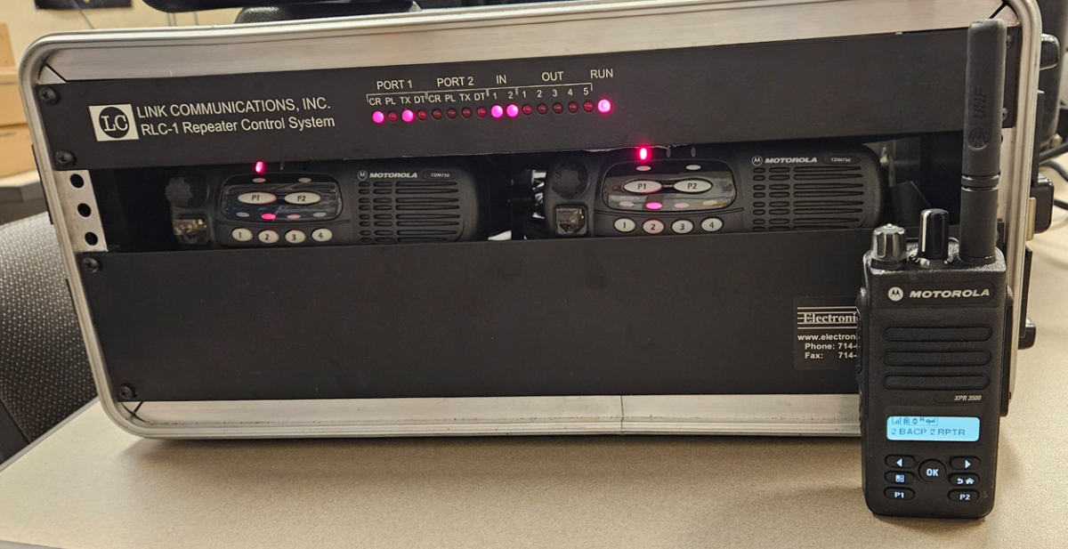

my portable RV repeater built with two Maxon 8402 radios fitted into an FAT-50 Ammo can can reach 85-90 miles with a J-Pole at higher elevation.  Doesn't do so well around wooded hilly areas. These radios don't require a controller and I draw power form my RV which is on solar so the radios fit into the can nicely with lots of extra room.   The can is vented and even fitted with a fan that kicks on via a heat sense controller inside. Pretty simple arrangement.  When I park at Lake Crawley the repeater actually get a lot of use by boaters and campers and it does in other areas as well.

I built a portable repeater system for use in amateur radio, using a Yaesu repeater. I stuffed it in a Gator Case. It is 100% self_contained for use on UHF. You need to add an external duplexer for VHF. My biggest problem is that the repeater itself is so large that I couldn't find a waterproof case that was at a price point I could live with.
I do like that setup in the tool boxes. I would slap a push/pull fan system on it for pull-through cooling and you could drop it anywhere, regardless of weather.  Right now, I deploy a 4-season shelter when I want to deploy it, or I run it out of the Jeep, if the weather is really bad and I don't need to be mobile while the repeater is in operation.
