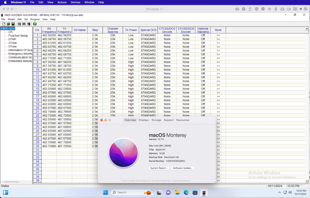

I tried the software with Windows 10 and it chocked as usual so I loaded it on my trusty old Windows 7 machine and everything is working smooth as silk. The radio even seems to be more reliable from the WRITES from Win 7.  I wish the had the software compatible with Ubuntu Linux.
