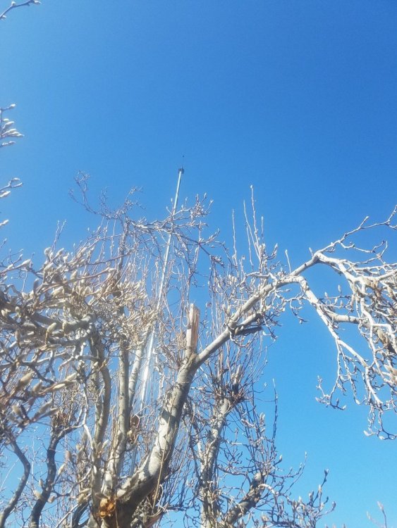

WRJW518 Posted December 31, 2023 Report Posted December 31, 2023 My antenna is Midland – MXTA26 MicroMobile® 6DB Gain Whip Antenna – Quadruple Signal Output – 32” Antenna at 20ft above house. My brother antenna is UAYESOK Fiberglass GMRS Base Antenna (462-467 MHZ), 7.2dBi High Gain UHF GMRS Repeater Antenna also 20ft above house. We are 30mile apart. I have midlan 15W transmitter and he can hear me just fine. He has 40 watt transmitter and I can kind of hear him. I know my antenna is tuned to 1.5swr. I don't know his antenna condition. Is he picking me up just because his antenna is better or would you be more suspicious of his tuning? Quote

0 WRJW518 Posted December 31, 2023 Author Report Posted December 31, 2023 I like the idea of swapping components one at a time. My radio is midland mxt115 15W. He also has same radio we tried at first. He could hear me fine, but I couldn't hear him. He swapped to 40W and I could kind of hear him. Don't know the make of 40W. I also realized my antenna Midland – MXTA26 MicroMobile® 6DB Gain Whip Antenna – Quadruple Signal Output – 32” Which is designed to go on a car. I am new to this and didn't realize the magnetic base antennas are using the car metal as a ground plane. My antenna is mounted on top of a 30ft metal pole, so it is not the way the antenna was designed. Whereas my brothers antenna is a UAYESOK Fiberglass GMRS Base Antenna (462-467 MHZ), 7.2dBi High Gain UHF GMRS Repeater Antenna which is designed to be mounted on a pole and has a ground plane built into it. My coax is 45ft of RG8X. I will need to drive up and find out his configuration. Quote

0 WRJW518 Posted December 31, 2023 Author Report Posted December 31, 2023 About 10 miles away there is a hill that prevents direct line of sight. But like I said he hears me perfectly. I'm leaning towards my magnetic based antenna as posted earlier. Quote
0 gortex2 Posted December 31, 2023 Report Posted December 31, 2023 Id get your antenna fixed first. At least get some sort of ground plane under the mag mount WRYZ926 and WRJW518 2 Quote
0 tweiss3 Posted December 31, 2023 Report Posted December 31, 2023 RG8x may be a start of your problem. Assuming cable length of 50' (you mentioned the pole is 30'), that 4db loss in the cable vs 1.35db in same length LMR400. Add in the no ground plane on on a mag mount antenna, and you have a severely hampered receiver. SteveShannon, WRUU653 and WRJW518 3 Quote
0 WRJW518 Posted December 31, 2023 Author Report Posted December 31, 2023 Ok, I got info on my brother's antenna cable. It doesn't have numbers on it but it is only 1/8 inch OD diameter and runs 100ft. I'm guessing since receiving doesn't take much power he can hear me, but when he goes to broadcast he is eating all his power up in the coax. Do you agree with that idea? I'm going to have him bump up to the LMR400 suggested by tweiss3 unless you suggest something different. He got the cable at radioshack. I guess he told the guy he needed 100ft coax for gmrs and that is what they gave him. My guess is the guy at Radioshack only recognized the word coax. Quote

0 SteveShannon Posted December 31, 2023 Report Posted December 31, 2023 25 minutes ago, WRJW518 said: It doesn't have numbers on it but it is only 1/8 inch OD diameter and runs 100ft. That’s probably a loss of nearly 90%. WRUU653, WRJW518 and arn 3 Quote
0 gortex2 Posted December 31, 2023 Report Posted December 31, 2023 If he has a 100' run he really needs LMR400 or equivalent. Hopefully RS gave him 50 ohm cable and not 75 ohm Cable TV cable. What connectors are on it ? If it has a F connector and adapters its definitely 75 ohm. If it has PL259 its most likely RG58 which is ok for CB or HF but not much good for UHF. WRJW518, WRUU653, arn and 1 other 4 Quote
0 WRJW518 Posted December 31, 2023 Author Report Posted December 31, 2023 Even though I think the problem is on his end, I'm going to replace my antenna and go to the LMR400 for a 50ft run. What antenna do you suggest for gmrs? I'm looking at (AYESOK Fiberglass GMRS Base Antenna (462-467 MHZ), 7.2dBi High Gain UHF GMRS Repeater Antenna Signal Booster for BTECH Midland Retevis QYT GMRS Radios HT Scanner Motorola Repeater) https://www.amazon.com/UAYESOK-Fiberglass-Antenna-Repeater-Motorola/dp/B0CF9DV3ZM/ref=pd_ybh_a_sccl_25/146-0695578-8370424?pd_rd_w=FBWAx&content-id=amzn1.sym.67f8cf21-ade4-4299-b433-69e404eeecf1&pf_rd_p=67f8cf21-ade4-4299-b433-69e404eeecf1&pf_rd_r=9DPYD2KNB8H9YJAMXRGS&pd_rd_wg=e3cVP&pd_rd_r=7a21f6a6-b3d9-4951-b510-185e6c2127f8&pd_rd_i=B0CF9DV3ZM&psc=1 Any other suggestion? Quote
