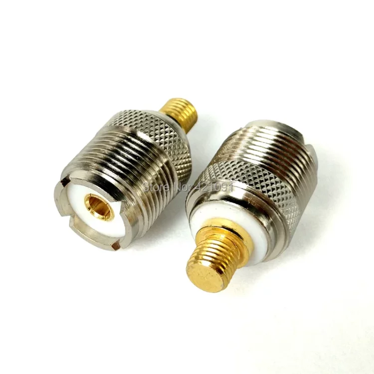

Which adapter fits the antenna mounting point for the Wouxun KG-Q10G??
WRNZ515
I own a Wouxun KG-Q10G.  Among other things I want to have it with me in my car as a backup GMRS, and I want to be able to connect it to my roof antenna's coax (with the standard UHF connector on the end of the coax) so that I can get more effective range.  Thinking it would fit onto the antenna mounting point of my KG-Q10G, I purchased a "UHF female SO-239 to SMA Female adapter" to connect the Wouxun to the coax for my magnetic mount roof antenna.  Seems simple enough.  So, I unscrewed the factory antenna off the Wouxun only to find out the hard way that---of course---the adapter I bought does not fit into the Wouxun!  What the heck!  I'm an old Army vet, so I came from a world where everything fits/everything is made to be compatable.  And I suppose the last thing the Wouxun manufacturers wanted to do was to make life at all simple by simply including in their operator manual any reference to the name/nomenclature/model of the kind of antenna socket they chose for that radio.   So folks, the obvious question is:  what stinkin' plug fits into/will screw into the Wouxun KG-Q10G antenna hole?  Thanks for your help.

Post a picture of the connector on the radio. There are at least four different permutations of SMA connectors.

The KG-Q10G sports a "non-removable" antenna. I have read where some have a drop of glue that can be removed easily and then others have broken the radio because it wasn't so easily removed. I'm guessing since the radio had to have a non removable antenna to be GMRS certified they didn't bother using a standard SMA fitting. I too would be interested in seeing a picture of the connection.

Thanks, Randy, but I as I mentioned in my initial question, I already got the factory antenna off (after it was actually you who answered my question posted in another forum about whether or not it comes off).  Based on your input (again, I appreciate that), I just applied a bit more turning torque than I was originally comfortable doing, and it worked!  Then, I bought the precise connector described in my initial question here...and again, it simply doesn't fit.  It just doesn't fit.  I'll attach photos here of the Wouxun radio, the factory antenna screw-in tip, and the adapter I bought, the end of which is clearly not the same as the screw-in tip of the factory Wouxun antenna.  As I said in my initial question, whatever that "SO-239" plug is, it is NOT the one Wouxun uses.  Does anyone recognize the type of screw-in plug that's on the end of my factory Wouxun antenna?  If so, please tell me what it is so I can buy an adapter.  Thanks.

Okay, I'm obviously mixing up the nomenclatures here.  But it doesn't matter;  it is neither an SMA plug nor a "SO-239" end that fits.  SMA or SO-239, whichever end it is, neither plug works.  It is something else entirely.  It is not an SMA end.

I just checked, and all of my standard SMA connecters fit perfectly into my Q10G - but when I look at the picture of your antenna, it looks like you broke your radio and the SMA connector is still attached to the antenna, leaving what is probably nothing more than a useless ragged-hole (much like my ex-wife) in the radio .
Compare the bottom of your antenna to the bottom of my antenna in my pic.

Ouch.  Thanks for the explanations, gentlemen.  Eye-opening.  If I'm seeing correctly, though, it isn't "'broken' broken" in that I am still able to screw it back into place and there's still a pin fixed into the center of/protruding from the hole on the radio itself that I did not break off.  That is, so apparently the wrong point unscrewed, and I get that now, but I don't have any reason to believe that doing so actually broke anything.  It screws right back into place where it was when I received it with no problem.  I suppose that at this point I could experiment to see if I can unscrew off of the tip of the antenna the part that SHOULD HAVE unscrewed had the factory not glued it on.  Very very very disappointing manufacture technique on the part of Wouxun.  With my straightforward desire to simply attach a car roof antenna it's not as if I'm trying to do something that would be beyond the scope of what that unit should legally be capable of doing, in that doing so would still be attaching just a different GMRS antenna with a very normal and very legal desire to simply use the GMRS band more efficiently with the alleged 6 watts that's pumped out by that now less than impressive radio (in a band that LEGALLY provides for the use of radios that are up to 50 watts).

GMRS radios are permitted to have removable antennas if they don’t transmit data, but if they transmit data the antennas are required to be non-removable.  That’s why some manufacturers glue antennas in place, in order to receive 95E certification from the FCC, which is necessary in the United States.  Other manufacturers, like Garmin, mold their antennas into their cases for the same reason.

I would agree that you might be able to unscrew the antenna jack from the antenna and put the radio back together.  Without knowing what kind of glue it’s difficult to advise you on how to separate them.  Heat might help. Some solvents might help. Heat and solvents might also make things worse.  We’ll cheer you on either way! 😁

I was also thinking maybe heat might help separate the pieces from the glue. Maybe acetone (nail polish remover). No hard science advice here, just ideas. I would certainly try to repair if possible and wish you luck with it. Disregard negative comments. This is absolutely the place to bring stuff like this.

I did this same thing to mine, but the center pin also came out.
I twisted the antenna off the part below the blue line in that picture using two pairs of pliers (and some electrical tape around the parts to mitigate damage from the pliers).
Then I dug out as much of the Loctite as I could. Mine had a little ball of it touching the pin inside the connector, which I assume is why the pin came out too.
I ended up pulling the pin all the way out of the connector so I could clean it, so when I re-inserted it I didn't go all the way in coz I wanted to make sure it made connection to the circuit board when I put it back in the radio hole. Then I screwed it down as best as I could using a dime (I don't even know what the proper tool for these rings is, and my needlenose pliers are too fat for the grooves). Eventually the pin came up and hit the dime so I had to improvise from that point on with a small screwdriver. But at least I know it's touching the circuit board where it should.
Then the brass ring had to go on, and it has a rubber ring underneath it to seal the whole thing up and make it submersible. Again, I had to improvise with a small screwdriver but I got it as tight as I could.
The radio works like it should. And I can change antennas now. I'm just not sure it's submersible anymore since I wasn't able to tighten everything as tight as I would like to. And I don't know if maybe I should have put something on the center pin to seal that part up as well. But the actual radio works just as well as it did when I got it.
