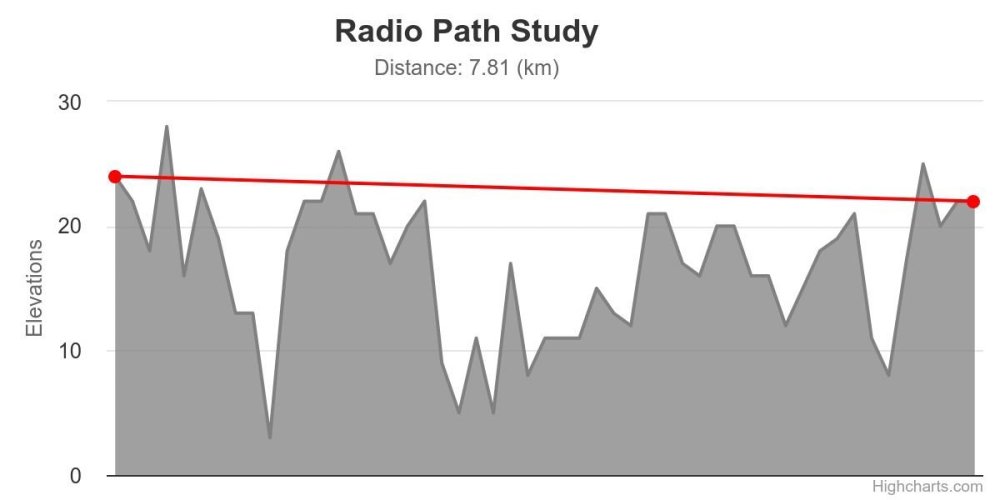

GreggInFL Posted March 15, 2024 Report Posted March 15, 2024 This is my profile to the local repeater, which is challenging to hit with a 5W given the vegetation. You may be fighting some elevation issues: https://www.scadacore.com/tools/rf-path/rf-line-of-sight/ SteveShannon 1 Quote
