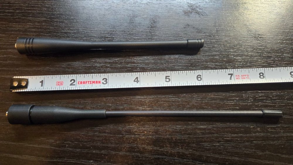

LeoG Posted June 3, 2024 Posted June 3, 2024 Does anyone know if the H3 GRMS antenna that comes with the radio is different than the one that comes with the H3 Ham radio? Quote
amaff Posted June 3, 2024 Posted June 3, 2024 45 minutes ago, LeoG said: Does anyone know if the H3 GRMS antenna that comes with the radio is different than the one that comes with the H3 Ham radio? I wouldn't have put a single dollar on them being different for a $35 radio, but I bought a pair of GMRS, then needed a couple more and liked them enough and accidentally bought a pair of Ham. They are indeed different. GMRS top, Ham bottom: GMRS: Ham: WRXB215 and marcspaz 2 Quote
LeoG Posted June 3, 2024 Posted June 3, 2024 Yup, I definitely have the Ham antenna. Do you notice any difference with the GMRS antenna vs the ham antenna? Is the compromise to get the lower frequency bands 136-174 hurt the transmit or receive efficiency of the Ham antenna vs the GMRS antenna? Or is it not noticeable? I'm like you, I like these radios and would like to get a few more. Just wondering if getting the GMRS version is any step up because of the antenna. I have ordered a couple of Smiley Rubber duck antennas for 2 of my radios. But they are close to $30 each which is about what you pay for the whole radio. So getting an optimally tuned antenna would be slightly advantageous to getting a compromise antenna that is good for GMRS and Ham. Quote
amaff Posted June 3, 2024 Posted June 3, 2024 The main difference I've been able to actually notice in real life use... ...is that the GMRS antenna is ~2" shorter, which means I can store them in 1 of my cases with the antennas on, but can't with the ham antennas I'm sure there is some difference at the very edges of the performance envelope, but the ham antennas seem to do fine on GMRS for me. They can talk on the same repeater at 50 miles as the GMRS antenna, with similar signal reports, and can talk simplex to my family at 4 miles (we're up on a hill, which obviously helps). In my use, I've not been able to tell any difference. WRXB215 1 Quote
LeoG Posted June 3, 2024 Posted June 3, 2024 That's kinda what I figured. It is designed for 400-470 which easily encompasses the 462-467 that we need. Like you said, shorter is a little more convenient. The Smiley's are something like 4" tall and 5/8 wave instead of the 1/4 wave the OEM antennas are. Looking forward to seeing if there is any real life differences between the two. Thanks for the info. amaff 1 Quote
