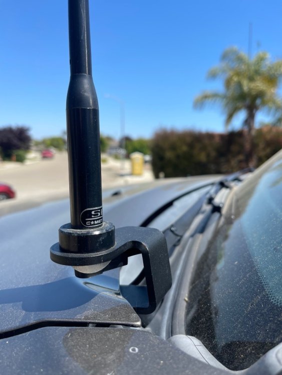

WRUU653 Posted June 19, 2024 Report Posted June 19, 2024 (edited) 3 hours ago, Lscott said: What kind of SWR do you get with the SBB-5 antenna on the Ham bands, MURS and GMRS? 1.0 on 146.520, 1.25 on 446.000, 1.83 on 151.940, 1.86 on 462.562, 462.550 and 462.725, and 2.38 on 467.625 Here is what I am using for a mount. It bolts on with the hood hinge bolts. It isn’t mounted as high as you have but it works and I have no complaints. Edited June 20, 2024 by WRUU653 Typo SteveShannon, WRXB215 and wayoverthere 2 1 Quote
