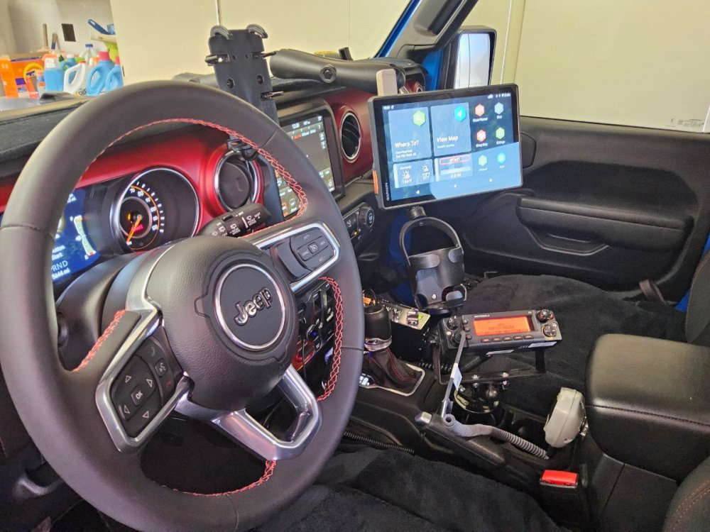

nokones Posted July 8, 2024 Report Posted July 8, 2024 2 hours ago, Guest grumpy jeeper said: Situation: Been using CB's since the 70's for offroading but it seems the cool kids are using GMRS (or HAM, don't get me going) now days. I wheel with some groups that use CB and it is still the go-to for some clubs so my mobile rig (CB) will stay for now but I do need to pick up a good handheld. My preference is "less is more", bells and whistles are not for me. I prefer good quality and being resistant to rain and dust are a must. The radio will be used for off-roading exclusively. I am not a big fan of Midland or Rugged and would like to avoid them if possible. Suggestions please, thanks! I would stay away from and don't spend your money on the CCR POS junk, and take a look at some of the Kenwoods and Motorolas that are offered for sale from several reputable used radio dealers that sell on eBay. There prices are very reasonable and there are various models that should meet your needs and last a long time. Also, I have both a Cobra 25 LTD Classic CB and a Motorola XTL5000 Remote setups in my 23 Wrangler Rubi 2 Dr. Quote

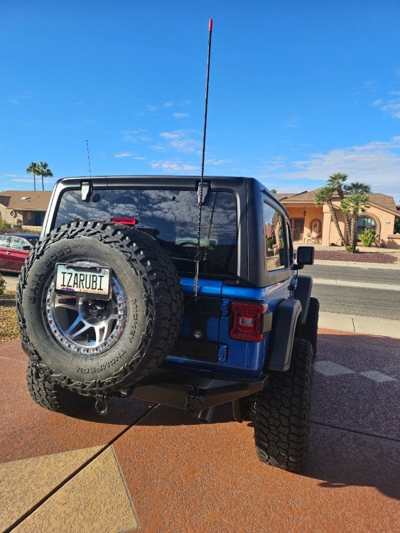

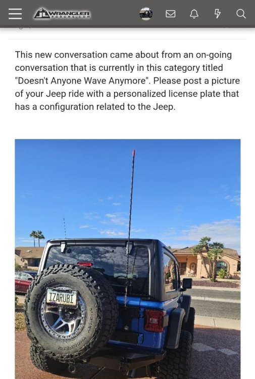

WSFE814 Posted October 19, 2024 Report Posted October 19, 2024 On 7/8/2024 at 6:53 PM, nokones said: I would stay away from and don't spend your money on the CCR POS junk, and take a look at some of the Kenwoods and Motorolas that are offered for sale from several reputable used radio dealers that sell on eBay. There prices are very reasonable and there are various models that should meet your needs and last a long time. Also, I have both a Cobra 25 LTD Classic CB and a Motorola XTL5000 Remote setups in my 23 Wrangler Rubi 2 Dr. I swear I've seen your plate in the JL forums. yep, found it Quote
nokones Posted October 20, 2024 Report Posted October 20, 2024 Yes, our beloved Queen's Jeep's license plate and his Business/Production name gave me the idea to come up with my license plate configuration. SteveShannon and WSFE814 2 Quote
