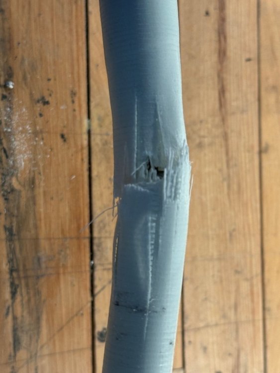

Don't go with a Hustler..  They are not Bird proof..   Although they are a damn good performer.  Mine (before the bird attack) got 1:1-1:2 across the GMRS band and talked 80 Miles.. Model is  GS-450-3..    I'm gonna try to repair it and repurpose..   Got a Laird FG460-470 ordered to replace it...  Lots and lots of good reports on that Antenna.  Best place to order is from Mouser Electronics..  If you order one, expect it to be backordered.   They cant keep them in stock.
