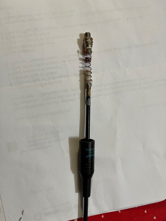

I am sour on the "771" antenna. The "factory provided" Nagoya 771 antennas I got directly from Baofeng are fakes... so says the Nagoya website.
Not dropping $30 a pop (shipping included) for replacements. The factory "Nagoya 771" antennas from Baofeng don't work as well as the "gimmie" antenna the radio comes with.
Sure, I could buy one directly from Nayoga but why put good money after bad. I will look for other options. Not Nagoya's fault but at the very least they could defend their brand by telling Baofeng not to sell the fakes. I guess they don't have the profit margins to hire layers to do that stuff.
(not interested in a "bidding war" here, you guys don't have to tell me all the places where I can get these antennas for less money. Don't waste your time.)
9 minutes ago, OffRoaderX said:
My comment was a bit of an "inside comment".. iYKYK ....
My comment was born of frustration, not directed at you are anyone else. The subject of these antennae popped up and triggered my ire.
It would be great if I could find a way to rebuild these, I have more time than the new antenna would be worth of money. For now, they make great fidget sticks. :)
Edit, here. Take a look at my "factory" Nagoya antenna. nothing but a connector and a length of spring wire. the overall length from the tip to the female pin in the connector is 38cm. No loading, nothing. Just looks like an antenna.
This appears to be a fake. I went searching because yours looked nothing like mine.
Mine was a TidRadio 771, but it has a coil and a capacitor from partway up on the coil to the shield. Here’s my picture.  Notice how thin the coil wire is?  I bet yours has a coil under a layer of insulation and it’s just not visible.
