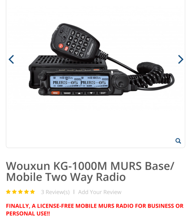

wayoverthere Posted December 5, 2024 Report Posted December 5, 2024 2 hours ago, TrikeRadio said: . only HT (hand held transmitters) not mobile units. and limited range. Ahem https://www.buytwowayradios.com/wouxun-kg-1000m.html WRHS218, WRUU653, WRXB215 and 1 other 4 Quote
WRQC527 Posted December 5, 2024 Report Posted December 5, 2024 5 hours ago, wayoverthere said: Ahem https://www.buytwowayradios.com/wouxun-kg-1000m.html Try as I may, I can't figure out why this is a $400 (with sales tax) radio. WRUE951 1 Quote
WRXB215 Posted December 5, 2024 Report Posted December 5, 2024 Just now, WRQC527 said: Try as I may, I can't figure out why this is a $400 (with sales tax) radio. Because they only made one. WRUU653, WRQC527 and SteveShannon 3 Quote

SteveShannon Posted December 5, 2024 Report Posted December 5, 2024 29 minutes ago, WRQC527 said: Try as I may, I can't figure out why this is a $400 (with sales tax) radio. It’s $369 (sales tax is simply a function of the state you live in) and it appears to be a retuned and reduced power version of the kg-1000g, which is $389. They probably didn’t start all over from scratch, and parts is parts, so with the possible exception of a couple of smaller final output transistors it would be priced similarly. The deletion of the higher priced finals could account for the $20 lower price. And @WRXB215 has a real point, they probably don’t anticipate selling a ton of 2 watt mobile radios so economies of scale play a small role. I’m less surprised by the cost than I am by the fact that they built the product at all. I wonder if they simply retooled a commercial radio. wayoverthere, WRUU653 and TrikeRadio 3 Quote

WRUU653 Posted December 5, 2024 Report Posted December 5, 2024 39 minutes ago, SteveShannon said: I wonder if they simply retooled a commercial radio It looks to me like both the KG-1000g and the KG-1000m look like the ham KG-UV980P. I don’t know if there are more versions out there or not. SteveShannon and wayoverthere 2 Quote
WRYZ926 Posted December 5, 2024 Report Posted December 5, 2024 Yes the KG-1000G and KG-1000M are the same radios as the KG-UV980P. Wouxun did take some of the menu items out of the KG-1000G when they went to the Plus model. And the KG-1000G can't be unlocked either. or at least I have not found anyone that has done it. So I am sure that the KG-1000M is also locked down tight. And to answer the original question. GMRS license are for individuals only. The local amateur radio club I belong to is actually a non profit organization. And we have to keep an individual's call sign assigned to the GMRS repeater where as we use a club call sign for the 2m and 70cm repeaters. WRUU653 1 Quote

TrikeRadio Posted December 5, 2024 Report Posted December 5, 2024 MURS is limited to 2 watts. I dont know about that mobile unit posted above but that is very uncommon. Most MURS units then are HTs. There is a height maximum of how high you can put an external antenna (can't find that at the moment) and the typical range you can expect is maybe 10 miles at most. so... yeah. More info onine: https://www.fcc.gov/wireless/bureau-divisions/mobility-division/multi-use-radio-service-murs WRQC527 1 Quote
wayoverthere Posted December 5, 2024 Report Posted December 5, 2024 1 hour ago, WRQC527 said: Try as I may, I can't figure out why this is a $400 (with sales tax) radio. @SteveShannon summed it up pretty well; between cost of parts for the base radios (as @WRUU653 mentions, it's based on the uv-980p, as is the kg1000g) and expected sales, it's not an inexpensive proposition. There's also the factor of spreading out the cost of certification across the expected sales, which doesn't play favorably here. Limitations wise, yeah, it does get a little questionable if it's worth a mobile though...kind of like trying to have a frs mobile...there was one made for a bit but it just wasn't practical nor worth the effort. On a side note, i dug a little more on Google and found one other mobile MURS radio advertised, but the mention made no mention of certification or a FCC id, and appeared to be a rebadged kt8900n(sold as a forklift radio). 1 hour ago, SteveShannon said: It’s $369 (sales tax is simply a function of the state you live in) and it appears to be a retuned and reduced power version of the kg-1000g, which is $389. They probably didn’t start all over from scratch, and parts is parts, so with the possible exception of a couple of smaller final output transistors it would be priced similarly. The deletion of the higher priced finals could account for the $20 lower price. And @WRXB215 has a real point, they probably don’t anticipate selling a ton of 2 watt mobile radios so economies of scale play a small role. I’m less surprised by the cost than I am by the fact that they built the product at all. I wonder if they simply retooled a commercial radio. Quote
TrikeRadio Posted December 5, 2024 Report Posted December 5, 2024 6 hours ago, wayoverthere said: Ahem https://www.buytwowayradios.com/wouxun-kg-1000m.html LOL OK... I guess there are mobile MURS radios... But really? $370 for a two watt radio? This looks like a desperate attempt to separate money from a business that does not know better. "hey look... a no-license-required two watt radio for your business needs. Hmmm. Quote
wayoverthere Posted December 5, 2024 Report Posted December 5, 2024 38 minutes ago, TrikeRadio said: LOL OK... I guess there are mobile MURS radios... But really? $370 for a two watt radio? This looks like a desperate attempt to separate money from a business that does not know better. "hey look... a no-license-required two watt radio for your business needs. Hmmm. Filling a niche almost no once else is in? may be good or bad depending if there's a market for mobiles or not. At least it's based on a decent quality radio and looks to be properly certified and legal, unlike the forklift one: https://forklifttrainingsystems.com/product/forklift-roger-radio/ WRUE951 1 Quote
WRUE951 Posted December 5, 2024 Report Posted December 5, 2024 2 hours ago, WRQC527 said: Try as I may, I can't figure out why this is a $400 (with sales tax) radio. $400 can buy one nice radio that would run circles around that Wouxun Quote

SteveShannon Posted December 5, 2024 Report Posted December 5, 2024 1 hour ago, TrikeRadio said: LOL OK... I guess there are mobile MURS radios... But really? $370 for a two watt radio? This looks like a desperate attempt to separate money from a business that does not know better. "hey look... a no-license-required two watt radio for your business needs. Hmmm. Maybe, but maybe not. It’s not just a two watt radio; it has an easy to see display, controls that can be used without removing gloves, and it can be made more rugged than a handheld simply due to the physical size. Plus it stays with the piece of equipment in which it’s mounted. A company might prefer it for those reasons, especially if they have had handheld units walk off accidentally. If you’re running a business and MURS radios have proven to work for you, and you want to permanently mount a radio in your forklifts, backhoes, or even the office, this form factor works better than a handheld. The simple fact is that businesses don’t care much about RF output as long as it’s enough. $369 for a radio used by a business just isn’t very expensive at all when compared to Motorola commercial radios. GreggInFL, WRYZ926 and AdmiralCochrane 2 1 Quote
