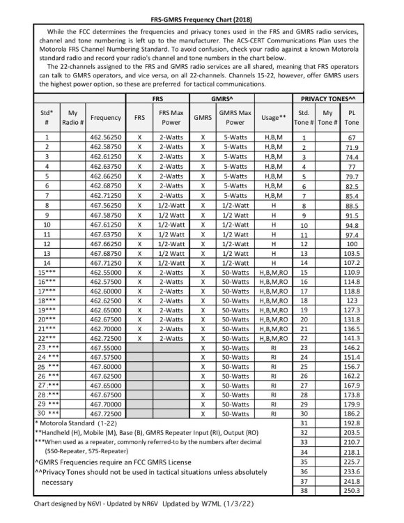

WRKY933 Posted December 22, 2024 Report Posted December 22, 2024 When making a channel chart there are some repeaters that have numbers such as Repeater 1 thru 7. What differentiates these repeaters. Are certain frequency range blocks assigned to certain repeater numbers? Does a number 3 repeater get a certain frequency range compared to a number 7 repeater? How does that work? Quote

SteveShannon Posted December 22, 2024 Report Posted December 22, 2024 9 minutes ago, WRKY933 said: When making a channel chart there are some repeaters that have numbers such as Repeater 1 thru 7. What differentiates these repeaters. Are certain frequency range blocks assigned to certain repeater numbers? Does a number 3 repeater get a certain frequency range compared to a number 7 repeater? How does that work? Eight frequencies have been designated in regulations for repeaters to transmit upon. They are the same eight frequencies used by both FRS and GMRS for simplex communications and they are numbers 15-22 in the FRS regulations: (a) 462 MHz main channels. Only mobile, hand-held portable, repeater, base and fixed stations may transmit on these 8 channels. The channel center frequencies are: 462.5500, 462.5750, 462.6000, 462.6250, 462.6500, 462.6750, 462.7000, and 462.7250 MHz. Eight other frequencies, 5 MHz higher in frequency, have been designated by regulation for transmission by stations wishing to transmit to a repeater for relay by the repeater: (c) 467 MHz main channels. Only mobile, hand-held portable, control and fixed stations may transmit on these 8 channels. Mobile, hand-held portable and control stations may transmit on these channels only when communicating through a repeater station or making brief test transmissions in accordance with § 95.319(c). The channel center frequencies are: 467.5500, 467.5750, 467.6000, 467.6250, 467.6500, 467.6750, 467.7000, and 467.7250 MHz. All GMRS certified radios pair the eight channels in those two groups into repeater pairs. Thus, a radio transmitting to a repeater on 467.5500 MHz receives from that same repeater on 462.5500 MHz. The FCC did not assign channel numbers to the repeater pairs in the GMRS regulations, but they did assign numbers to the first 22 channels in the FRS regulations https://www.ecfr.gov/current/title-47/chapter-I/subchapter-D/part-95/subpart-B Because channels 15-22 (462 MHz main channels) are dual purpose, as shared simplex channels for FRS and GMRS and as repeater output channels, some manufacturers refer to the repeater pairs as RP15 - RP22. Others simply continue the numbering sequence by referring to the repeater pairs as channels 23-30. Other call them repeater channels 1-8. The best thing to do is to be aware of the frequencies allocated in regulation and learn what your radio manufacturer calls them. Raybestos, WRKY933, GreggInFL and 2 others 3 2 Quote

WRKY933 Posted December 22, 2024 Author Report Posted December 22, 2024 23 minutes ago, SteveShannon said: Eight frequencies have been designated in regulations for repeaters to transmit upon. They are the same eight frequencies used by both FRS and GMRS for simplex communications and they are numbers 15-22 in the FRS regulations: (a) 462 MHz main channels. Only mobile, hand-held portable, repeater, base and fixed stations may transmit on these 8 channels. The channel center frequencies are: 462.5500, 462.5750, 462.6000, 462.6250, 462.6500, 462.6750, 462.7000, and 462.7250 MHz. Eight other frequencies, 5 MHz higher in frequency, have been designated by regulation for transmission by stations wishing to transmit to a repeater for relay by the repeater: (c) 467 MHz main channels. Only mobile, hand-held portable, control and fixed stations may transmit on these 8 channels. Mobile, hand-held portable and control stations may transmit on these channels only when communicating through a repeater station or making brief test transmissions in accordance with § 95.319(c). The channel center frequencies are: 467.5500, 467.5750, 467.6000, 467.6250, 467.6500, 467.6750, 467.7000, and 467.7250 MHz. All GMRS certified radios pair the eight channels in those two groups into repeater pairs. Thus, a radio transmitting to a repeater on 467.5500 MHz receives from that same repeater on 462.5500 MHz. The FCC did not assign channel numbers to the repeater pairs in the GMRS regulations, but they did assign numbers to the first 22 channels in the FRS regulations https://www.ecfr.gov/current/title-47/chapter-I/subchapter-D/part-95/subpart-B Because channels 15-22 (462 MHz main channels) are dual purpose, as shared simplex channels for FRS and GMRS and as repeater output channels, some manufacturers refer to the repeater pairs as RP15 - RP22. Others simply continue the numbering sequence by referring to the repeater pairs as channels 23-30. Other call them repeater channels 1-8. The best thing to do is to be aware of the frequencies allocated in regulation and learn what your radio manufacturer calls them. Thanks Steve, that info helps. Jeff Coder K7JXB/WRKY933 SteveShannon and WRUU653 2 Quote
WRKC935 Posted December 22, 2024 Report Posted December 22, 2024 (c) 467 MHz main channels. Only mobile, hand-held portable, control and fixed stations may transmit on these 8 channels. Mobile, hand-held portable and control stations may transmit on these channels only when communicating through a repeater station or making brief test transmissions in accordance with § 95.319(c). The channel center frequencies are: 467.5500, 467.5750, 467.6000, 467.6250, 467.6500, 467.6750, 467.7000, and 467.7250 MHz. Meaning they are there, as part of the frequency allocation, but are NOT to be used for general simplex communications without communicating through a repeater. So they are extra channels how? Regulations say they can't be used for simplex operation, so they really aren't for general use. Quote

nokones Posted December 22, 2024 Report Posted December 22, 2024 8 hours ago, WRKC935 said: (c) 467 MHz main channels. Only mobile, hand-held portable, control and fixed stations may transmit on these 8 channels. Mobile, hand-held portable and control stations may transmit on these channels only when communicating through a repeater station or making brief test transmissions in accordance with § 95.319(c). The channel center frequencies are: 467.5500, 467.5750, 467.6000, 467.6250, 467.6500, 467.6750, 467.7000, and 467.7250 MHz. Meaning they are there, as part of the frequency allocation, but are NOT to be used for general simplex communications without communicating through a repeater. So they are extra channels how? Regulations say they can't be used for simplex operation, so they really aren't for general use. Show me where in the rules it says you cannot use them as simplex channels, and if two or more stations are prohibited from conducting test messages with each other, and what the context of those test messages shall contain? Nor does the rule defines the time period of what is a brief period of time and that is subjective. Quote

nokones Posted December 22, 2024 Report Posted December 22, 2024 13 hours ago, OffRoaderX said: I just saw a video on the Youtube that explains this exact question: Since, the eight 467 main channels could be used as private test channels, I think they need to be numbered. The eight repeater paired channels are numbered as RPT-22 through RPT-30 or 23 through 30 respectively, maybe the 467 main private test channels should be numbered channels 31-38, respectively. Quote

WRYZ926 Posted December 22, 2024 Report Posted December 22, 2024 To answer the original question. It depends on the radio manufacturer on how they list the 8 repeater channels. Some manufacturers will list them as Channels 23 through 30 while others will list them as repeater channels 1 though 8 and will abbreviate repeater as RPT. so the radio screen will show RPT1 though RPT 8. No matter how each manufacturer labels the repeater channels, they are the same across the board. All GMRS radios will transmit on 467.XXX to the repeaters and will receive the repeaters' output on 462.XXX. And all GMRS repeater use a positive offset of 5 MHz. Again, I will leave the arguing about if it is okay to use the repeater input channels for simplex to others. The FCC regulations have been posted for those who care about following them. Quote
OffRoaderX Posted December 22, 2024 Report Posted December 22, 2024 2 minutes ago, WRYZ926 said: Some manufacturers will list them as Channels 23 through 30 while others will list them as repeater channels 1 though 8 I'm testing a new radio right now that lists the repeaters on channels 45 - 52 ... .I dont know what they were thinking... Raybestos, AdmiralCochrane and SteveShannon 3 Quote
