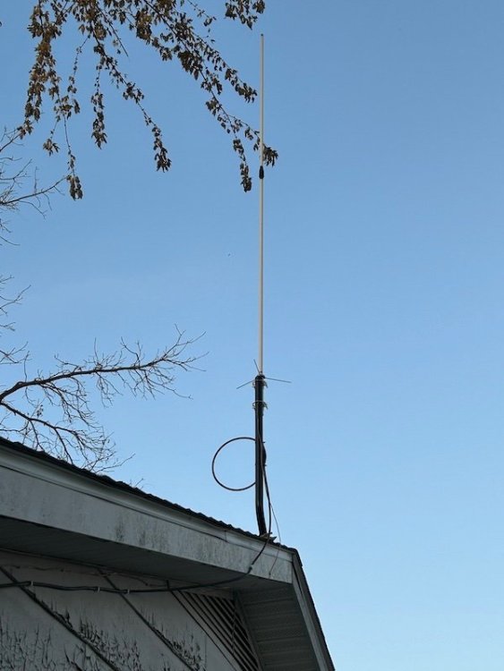

warthog74 Posted January 30 Report Posted January 30 7 hours ago, jwalsh7107 said: I was planning on putting a j pole at the peak and then mount an antenna to it. I am open on recommendations for an antenna. I use one of these for my 5 watt GMRS repeater. https://www.jpole-antenna.com/shop/462-mhz-land-mobile-gmrs-j-pole-antenna/ Cheap, light, and works well. You’ll want to get it higher than 18 feet though. Trust me. I ended up using a 30 foot flag pole, then i attached 2 10 foot aluminum poles on top of that. Antenna now sits at 50 feet and covers 10 miles of city and rural mixed. At 30 feet i barely got 5 miles. However at 30 feet, it should have no problem covering your 250 acres. Quote
