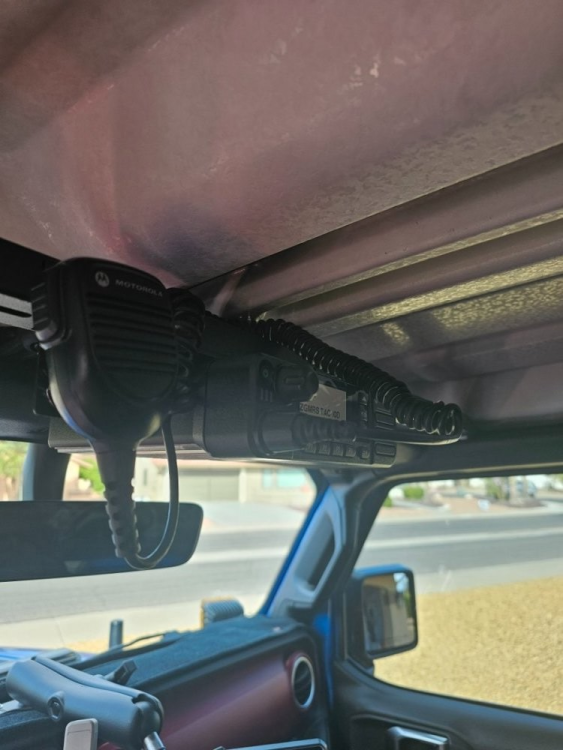

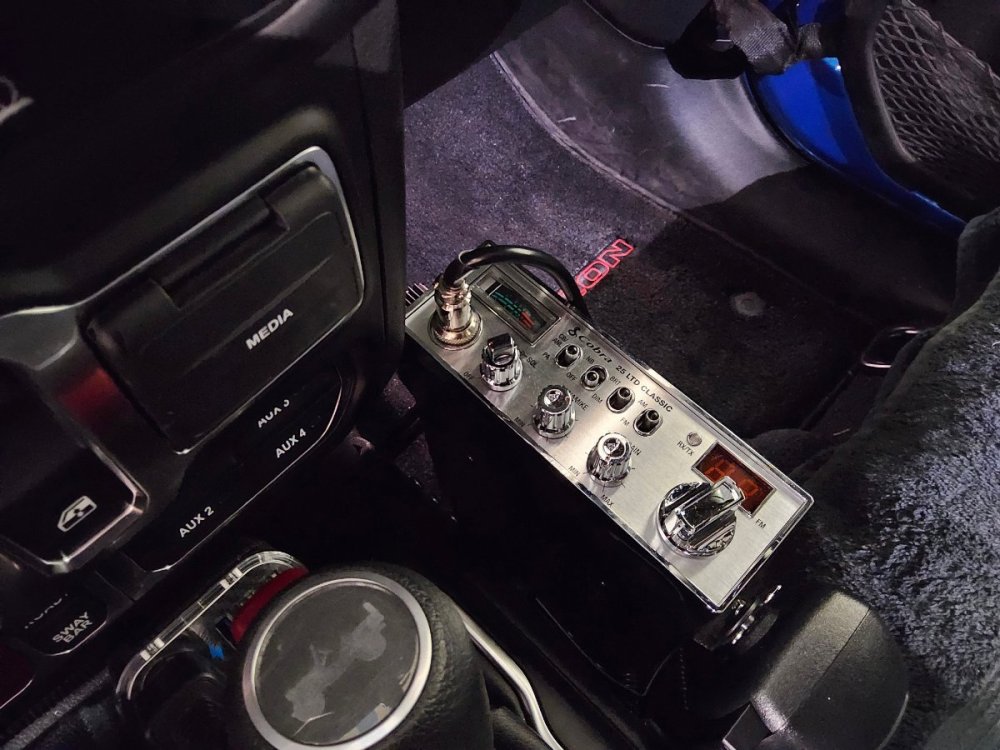

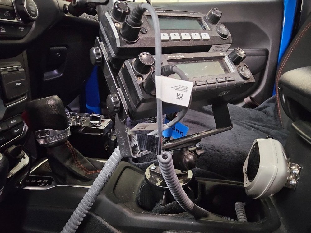

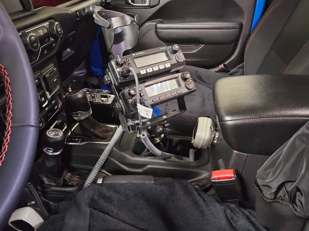

WRUE951 Posted April 14, 2025 Posted April 14, 2025 23 minutes ago, nokones said: There are three good places to hard mount an under dashmount radio in a Wrangler, especially a MXT500. Hell, I even have 4 radios in my Wrangler, two under dashmount type, and two with remote controlheads with the radio units mounted behind the two front seats on the floor, and I have the 4 radios powered by the Aux 1 circuit. I had a radio mounted on the center dash above that small storage pocket it blocked precious viewing while 4 wheeling. I tried mounting the FT900 control head on either side of the center console, it was a major pain for viewing. The best place to mount it was above the rear view mirror. The 4th place, the center glove box worked perfect for the MXT575 mic and i could even pull and use the mic with console closed. Had a buddy that put created a center din mount on his 3D printer and he two Icoms in there nicely. He used a JBL Marine style control head stashed in his glove box for his stereo. Nice set up... Quote
Lscott Posted April 14, 2025 Posted April 14, 2025 Not exactly a "budget" radio but this one you're unlikely to out grow. Plus it won't have some of the frustrating programming limitations various GMRS specific radios exhibit. If at some point one wanted to move into Ham Radio the 400MHz to 470MHz band split is perfect. With a cheap feature license key the radio can be enabled to do either NXDN or DMR digital voice. The only down side is the radio is NOT part 95 certified, Part 90 yes. So far the FCC doesn't seem to mind the Part 90 radios so long as they are carefully programmed to conform to the rules. Maybe as some point they will just throw in the towel and officially allow the practice, enough people are already doing it. The radio shares the same programming software as the NX-1300 HT's, and I believe you can exchange code plugs between them. https://forums.mygmrs.com/gallery/image/290-nx-1300duk5/?context=new The software can be found on the Internet so the cost with getting the license key for it isn't an issue. The attached catalog pages are from 2024 so the price may have gone up a bit. I have an older NX820 that is very usable for GMRS and Ham Radio, and likely can be found for a reasonable price on some of the well known auction sites. You just wouldn't be using the digital part for GMRS however. https://forums.mygmrs.com/gallery/image/250-nx-820ghjpg/?context=new I looked at the price for a Midland MXT575, at it was cheaper, but considering the difference in quality and features the Kenwoods would be a smarter choice. Kenwood NX-1800.pdf tcp2525 1 Quote
nokones Posted April 14, 2025 Posted April 14, 2025 22 minutes ago, WRUE951 said: I had a radio mounted on the center dash above that small storage pocket it blocked precious viewing while 4 wheeling. I tried mounting the FT900 control head on either side of the center console, it was a major pain for viewing. The best place to mount it was above the rear view mirror. The 4th place, the center glove box worked perfect for the MXT575 mic and i could even pull and use the mic with console closed. Had a buddy that put created a center din mount on his 3D printer and he two Icoms in there nicely. He used a JBL Marine style control head stashed in his glove box for his stereo. Nice set up... This is what I used for my two remote controlheads. It is a Ram Mount setup and since the MXT500s are on the small side, you could do the same thing. I used a similar setup temporarily in my Pickup for a Kenwood radio. WRUE951 1 Quote
