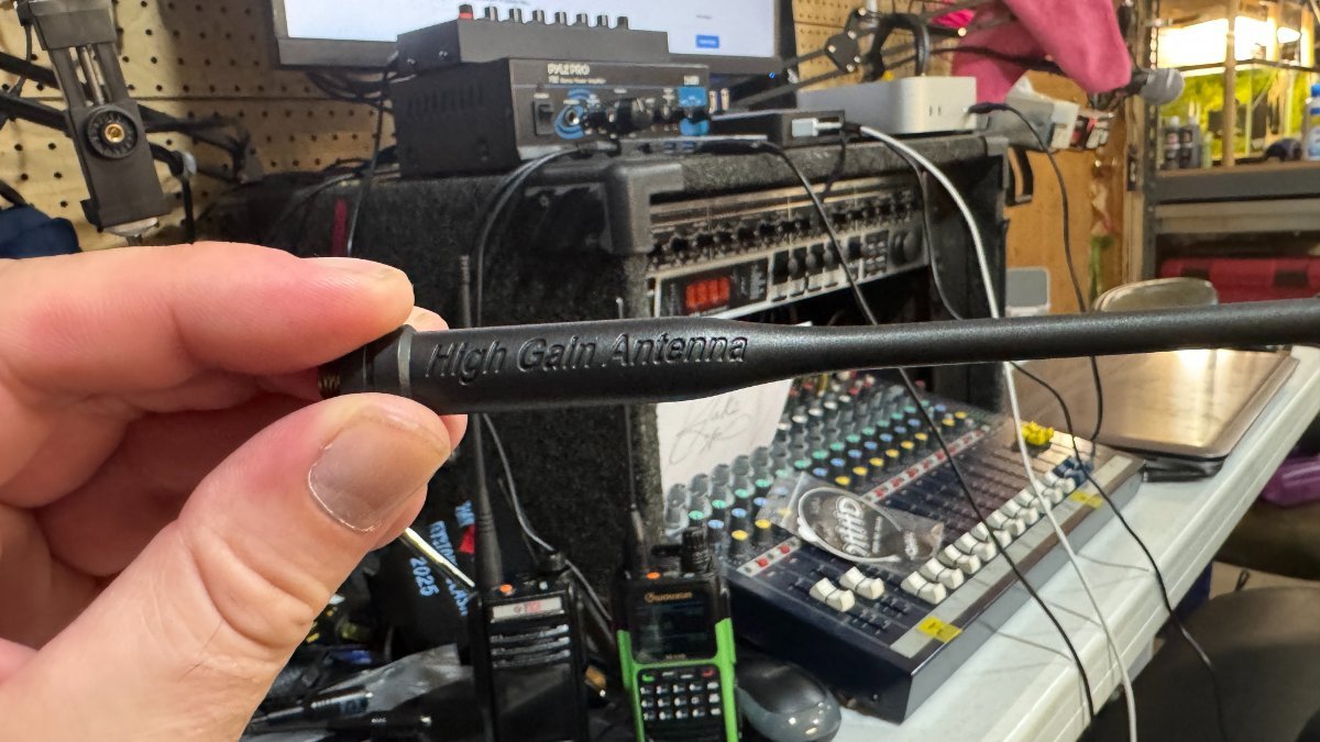

This is the antenna that comes on a KG-Q10G.  Can you make out the writing on it?
So what is the gain?  The highest gain antenna I've seen for an HT is 3dBi.  Which is really .85dB gain.  Not much of a gain.  If it's listed in dBi then subtract 2.15 to get the real gain of the antenna.  And another observation, that's a removable antenna.  We were talking about non removable antennas.
And manufacturers never lie about their products.
I looked up the radio and the only thing is says about the antenna is it is non removable.  So it was equipped with the radio and got the FCC approval with that antenna so the ERP is fcc approved with that antenna, no matter what it's gain is.
Which also means you are now operating a non compliant radio.
