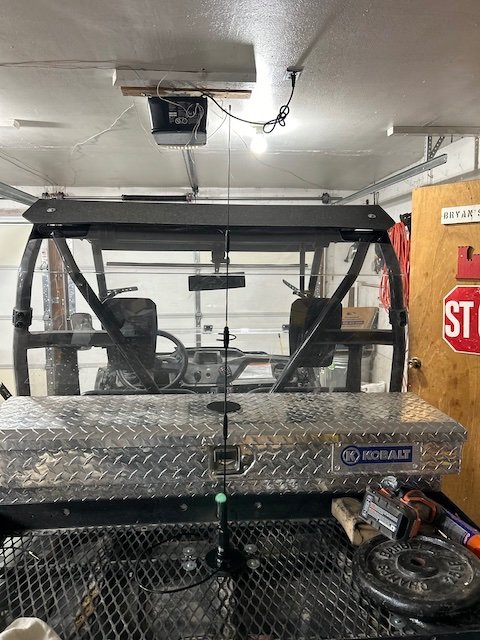

WRYZ926 Posted November 21, 2025 Posted November 21, 2025 The downside to having a single antenna that works on 2m/70cm and GMRS is that it will be tall. Most are around 35-40 inches tall. While I do run the Comet 2x4SR on my SxS and truck, I run separate antennas on my SUV since I park it in the garage. I run a Comet SBB-1 dual band and a Tram 1174 tuned for GMRS. Raybestos, AdmiralCochrane, NCJeb and 1 other 4 Quote

WSAM454 Posted November 25, 2025 Posted November 25, 2025 On 11/21/2025 at 8:35 AM, WRYZ926 said: The downside to having a single antenna that works on 2m/70cm and GMRS is that it will be tall. Most are around 35-40 inches tall. While I do run the Comet 2x4SR on my SxS and truck, I run separate antennas on my SUV since I park it in the garage. I run a Comet SBB-1 dual band and a Tram 1174 tuned for GMRS. Yes, the 7900 is a bit over 5' tall, and the maker does not suggest using a mag mount for it. Quote

WRYZ926 Posted December 2, 2025 Posted December 2, 2025 On 11/24/2025 at 10:30 PM, WSAM454 said: Yes, the 7900 is a bit over 5' tall, and the maker does not suggest using a mag mount for it. My brother has a 7900 and a triple magnet mount would not hold it to the roof of his truck at 60-70 MPH. A permanent mount is needed. He went with the Comet 2x4SR instead. WSAM454 1 Quote
