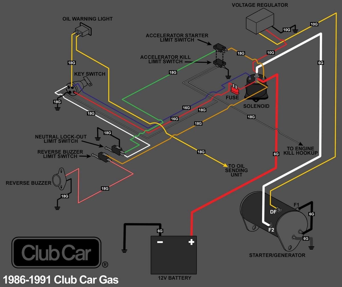

Hi James,
I don’t know which model or vintage of Club Car cart you have, but at least some models do have a charging system.  You’re correct that it’s not an alternator, but the starter motor doubles as a generator in order to recharge the battery capacity that was depleted when starting and to support some  electrical devices. You might see running voltages change as the voltage regulator switches on and off.
You can always check the battery voltage when the engine is off and then when it it running to see how many volts the starter-generator puts out.
I do have one question. Does the engine run all of the time or does it stop when you are not moving?
I know some carts will shut the engine off when you aren't actually moving. I don't remember if the older Club Cars are that way or not. That will have to be taken into account.

Ah, finally a very simplistic and not overly complicated answer to a simple problem. I am not sure why he needs to put it on a battery tender at the end of the day as the charging system in these Club Cars are more than adequate. Since he will be yakking on his new radio he would definitely benefit from using the tender to prolong battery life.

The golf cars do have a charging system or the battery would discharge too many times and piss off the old people.

For the Club Car gurus.
Do the gas versions use a standard automotive type battery or  motorcycle type battery?
I would be a bit worried if it's a small motorcycle battery. I have had issues in the past with adding 12v accessories on motorcycles and UTV's in the past with such small batteries.

They generally take a smaller size automotive battery, but I have found out a good quality motorcycle battery on my Goldwings has never let me down when transmitting 50 watts. Obviously, the Goldwing has a much more powerful charging system than a golf cart.
