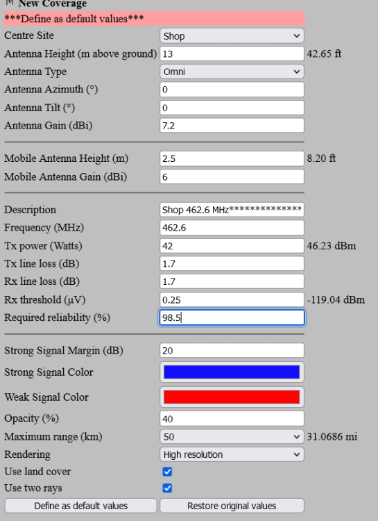

An RF Engineer in Quebec (whom is also an amateur radio operator) has a website with a free online calculator that will help the knowledgeable radio user visualize an estimate of what there coverage would be based on many of the fundamental factors that affect radio coverage. Having now contrasted its calculated results with my personal radio experiments, I am gaining confidence in its ability to “get me close.” better than any other way.
For example, in some of my tests of base to HT and base to mobile coverage, the software predictions correlate with many of the spots, even along mostly level ground, where I experience complete radio dropouts, where I experience marginal reception, and where I experience highly reliable communications.
Here are some of the user supplied factors that go into estimating one’s coverage:
Location of Tx antenna.
Transmit Frequency.
Tx antenna height.
Tx antenna gain, tilt, azimuth.
Tx output power.
Signal loss in Tx cable
Rx antenna height.
Signal loss in Rx cable.
Real-world receiver sensitivity (which may or may not be published accurately).
The calculator can be found here: https://www.ve2dbe.com

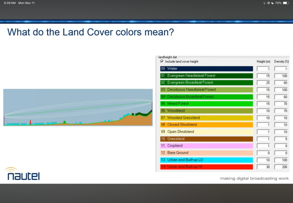

The software takes into account the actual terrain around the antenna. It appears as though it may be adding factors related to ground coverage, which I assume is based on some statistical information. More detail about what goes into the calculations can be found here: https://www.ve2dbe.com/rmonlineinfoeng.html
I have been wresting with determining whether there would be real-world benefit to me adding another 20-40 feet of height to my proposed GMRS antenna mast/tower. What I really wanted to know is if I would experience tangible or zero benefit from increased height when it comes to simplex coverage around my property. I feel much better informed now.
I would be most curious to hear from those of you strong technical types regarding how predictions from the software align with your real-world conditions when it is configured accurately.

My only comments would be that you need to bump up the "Required Reliability" % to something North of 95% to better reflect actual coverage. Also, realize that it's mapping Talk Out coverage for the most part - not taking into account the difference between a mobile mounted radio or a portable (other than antenna gain & height). I usually set antenna gain at Zero for a portable, with a 1 meter antenna height. I find that gives me a more accurate representation of Real World talk back conditions with a decent portable.

some things to keep in mind. gain is in dBi subtract 2.1 dB if antenna is rated in dBd.
line loss , don't forget the insertion loss of your duplexer typically .5dB-1.5 dB on average.
now the "required reliability" can change the map dramatically. I find that 85% works well in most applications.
