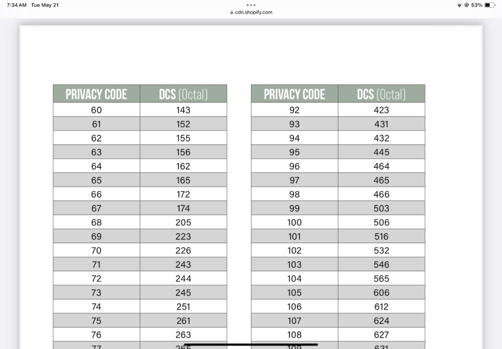

That means to not share their Tones.
Do any of these look familiar?
Link to comment
Share on other sites
Yes, but i spend more than half my day at work up in Waukesha, so the one ive been trying to program manually while waiting for the proper programming cable is Armor 1. I believe i have it programed correctly. I just did not know what the PL/DPL he gave me were since everyone talks about tones and ctcss. I attempted to make contact on the drive home with anyone, i maybe got a response but could not hear them so im not sure.
