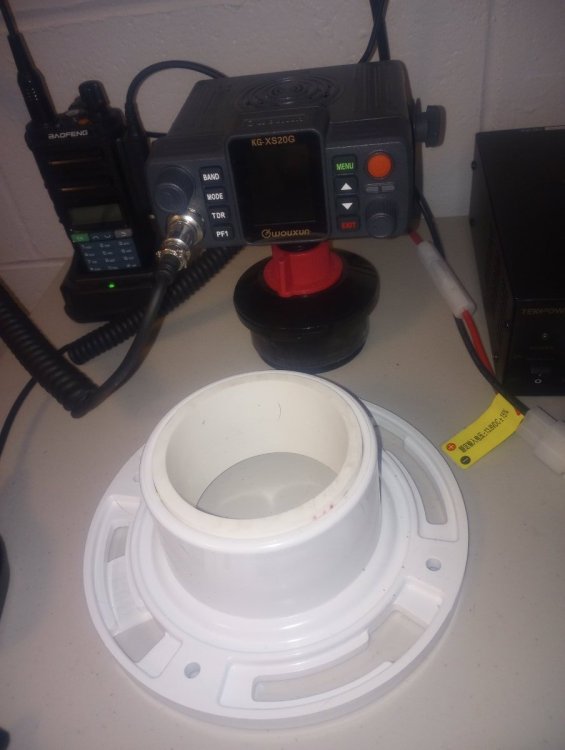

0 Newb Posted February 23, 2024 Author Report Posted February 23, 2024 I tried the commercial mounts but there is too much vibration on rough roads and off road. I have what looks like a similar GM vehicle and I don't have any problems. I started using heavier radios and had to raise the mount so the console lid would clear. Haven't had any fallout problems. I wanted to use my mobile radios at my base. I'm using 3"/4" stool flanges to make them stable. As you can see, I raised my KW8150 about 6 " and it is stable in the console. The 8150 is a tank so the mounts he is suggesting wouldn't work for me. They would be broken in a week on the road. Quote
0 nokones Posted February 24, 2024 Report Posted February 24, 2024 Try a Ram Mount RamCan and wrap industrial strength Velcro strips around the portion of the RamCan that is placed in the Cup Holder Quote
0 Newb Posted February 24, 2024 Author Report Posted February 24, 2024 Another suggestion would be, check to see if a short section of 3" pvc will fit in the cup holder to remove the slack in any cup holder for any mount that has slack. Quote
0 Newb Posted February 24, 2024 Author Report Posted February 24, 2024 The red wing nut on the plug is used to tighten the bottom. The short piece of pvc you add to the top will hold it in place at the top. Quote
0 Newb Posted February 24, 2024 Author Report Posted February 24, 2024 I read through the entire post and found I left out that one of the later plugs that I purchased needed a little plastic safe lubricant added to the inside of the rubber plug so it would expand easier. Quote

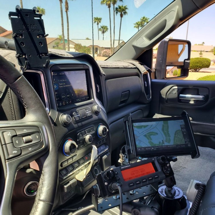

0 Newb Posted February 24, 2024 Author Report Posted February 24, 2024 My XPR 4550 in my GM truck. SteveShannon 1 Quote
