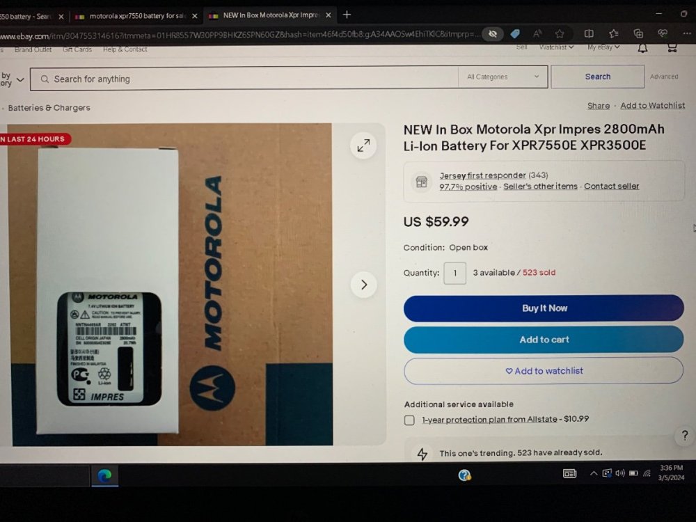

PACNWComms Posted November 10, 2023 Author Report Posted November 10, 2023 I should add that these fake batteries are also being sold as replacements for APX900 and APX4000 series Motorola radios as well. Had another site and incident where these counterfeit batteries entered the supply chain as "stores" batteries, spares purchased in bulk across the enterprise, to replace equipment damaged/used/lost during emergency response incidents. This was the battery in question and website for purchase details - I DO NOT RECOMMEND anyone buy these batteries! https://www.grainger.com/product/BANSHEE-Radio-Battery-Fits-Motorola-52XP74 Quote
Luish19779 Posted March 5, 2024 Report Posted March 5, 2024 Here is the eBay store who sale those batteries…Jersey firts responders. People talk about this in the store reviews… Quote
