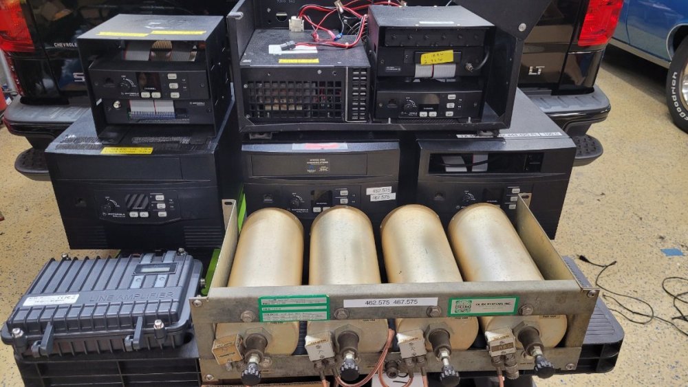

Flameout Posted December 4, 2023 Report Posted December 4, 2023 Have you looked into the older Motorola GR500/GR1225 repeaters? Can usually be found for a few hundred dollars with duplexer so all you need is a GOOD antenna and elevation. I actually have a few of them, with one set up in my area. It works good, but gmrs is kind of dead here. I also have a Retevis RT97 that I tried out for a week or so. I tried selling a complete, tuned (.650) lower power GR1225 locally but no one was even interested Quote
