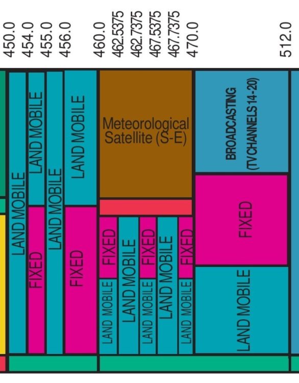

I have seen this chart and also a noob here, so I am learning to read it....GMRS falls within the Land Mobile/Fixed realm?
It falls in the same frequency range but GMRS is considered one of the personal radio services defined in part 95.
Defining every individual channel is beyond that chart.
