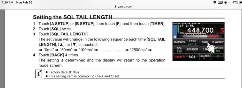

My last repeater (Yaesu DR-2X, same one Steve showed) had a STE programmable value on it.  There are no references to Hang Time nor Reverse Burst in the owners manual... but I know that it had a Hang Time function and a Reverse Burst function, too.  I'm at work right now, so I don't have a lot of time, but I can see if there is anything in any of the advanced manuals later tonight.

  On 2/26/2024 at 11:22 AM, Sshannon said:
DDA10A42-21DF-43D5-9BCE-DCCAD13DC013.thumb.jpeg.ad202db23448e1681478f920f4bdd00a.jpeg My repeaters are XPR’s on my commercial pairs and my GMRS repeaters are Tait TB8100’s.
I also have kenwood TKR’s and NXR’s on the stock pile and  the difference is that all the commercial gear call it hang time.
Expand
