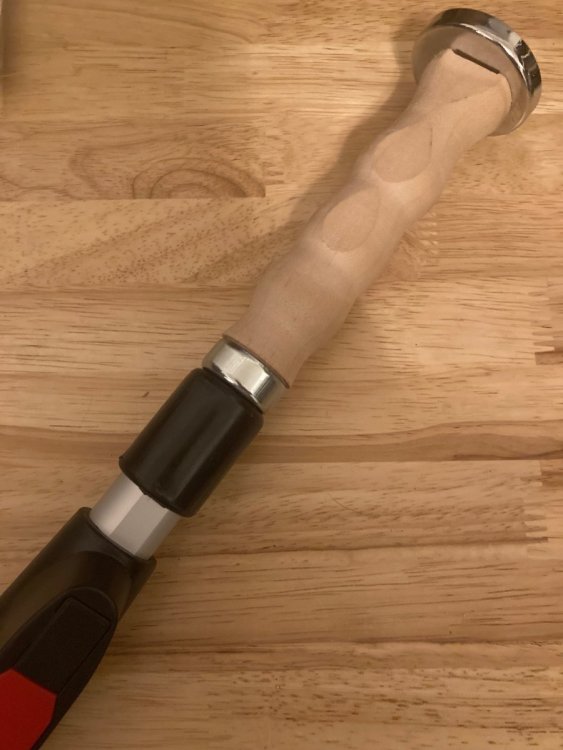

WSGI548 Posted February 17 Report Posted February 17 Well, I admit it took a little ingenuity to do what I wanted… I bought a wood handle paint roller frame($5), then knocked the metal frame off. I used a large hollow wall anchor down the hole where the frame was with a little glue. I then Attached a 25lb magnet ($7) from home depot via screw to the hollow wall anchor. The pizza pan started out a 16” from a dollar store, but I went back and bought a 12” after reading about the size of ground planes, both worked equally well, but the smaller one was a touch easier to deal with. And I ended up with the below. Allows me to attach and detach everything to set it up/down. edit-Just saw you asked about the base. It came from Walmart, a 26lb umbrella stand. Has different size shaft adapters and only cost $20. Has two little thumb screws to snug everything down. SteveShannon and GreggInFL 1 1 Quote

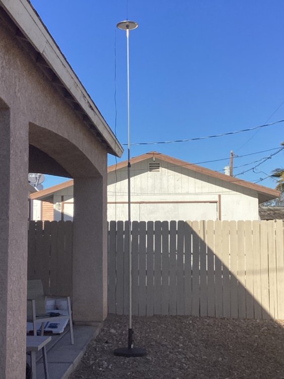

WSGI548 Posted February 17 Report Posted February 17 This is my newest attempt to get a better antenna up. It is a threaded extension to pool pole adapter ($9). It has 3/4x5 acme threads, same as broom handle or extension pole, then goes to 1.25 push button to use pool pole accessories and has set screws to snug it down on the threads. I ordered some push button pool pole adapters($10 pr) off amazon to use with it. I will be remounting the antenna on the black adapters, then they can be attached and detached easily, with the antenna mounted, when I want to setup or take down. I ordered some RG8X with bncs on both ends, as well as some adapters. This should allow me to have different antennas, yagi, omni, etc, and quickly attach or detach to swap them. It is still a work in progress. My goal was to be home usable, but also field usable in case. SteveShannon 1 Quote
gortex2 Posted February 17 Report Posted February 17 I have to agree with socalgmrs which bothers me but spending a bit more up front on proper gear normally results in happy life and better performance. Ive seen many folks come on here, get annoyed when they use inferior gear then get disgusted with performance and disappear. If your serious about the service buy stuff made for the service and use it. Very few of the GMRS users are on this site. The majority of GMRS users buy a GMRS radio and talk and dont care about all the bells whistles and other stuff. Quote
WRYZ926 Posted February 17 Report Posted February 17 @gortex2 I feel the same way as you do on this. By the time you buy a mobile antenna then spend as much if not more to try and make it work better as a base antenna yo have spend enough to buy a good base antenna. The only saying to buy the proper tool for the job comes to mind. It is usually better to just spend a little more and buy the correct base antenna to begin with. That being said, yes I have used a mobile antenna with mag amount attached to a cookie sheet in the past. But that was only a temporary setup until I could get an actual base antenna installed. I fully understand why some will use a mobile antenna with some type of home made ground plane in certain situations such as dealing with HOA restrictions, needing a more temporary setup, or something that can be quickly taken down for severe storms. WRNU354 and WRUU653 2 Quote
SteveShannon Posted February 17 Report Posted February 17 1 hour ago, WSGI548 said: I ordered some RG8X with bncs on both ends, as well as some adapters. This is the only thing in your post that gave me heartburn. RG8x is terrible for GMRS. If you’re using more than just a very short length you’re attenuating a significant portion of your RF output in the cable before it ever gets to the antenna. Fifty feet of RG8X attenuates 62% of the signal. 50 watts out of the radio becomes 18 watts delivered to the antenna. https://kv5r.com/ham-radio/coax-loss-calculator/ AdmiralCochrane, WRYZ926, GrouserPad and 1 other 4 Quote
WRYZ926 Posted February 17 Report Posted February 17 You are still looking at 45% loss using 30 feet of RG-8X at 467 MHz. You would have to use a pretty high gain antenna to overcome the loss with a 30 ft section of RG-8X. 2 dBd of gain still shows a loss in power output (ERP). You would need at least 4 dBd of gain to overcome the coax loss of 30 feet of RG-8X. Getting LRM400 or equivalent will greatly improve things. Look at the DX Engineering 400MAX or even the Jet LMR400 equivalent from R&L Electronics. Both brands work well and are definitely cheaper than Times Microwave LMR400. RG-8X is fine for jumpers that are 6 feet or less in length. SteveShannon 1 Quote
WSEZ864 Posted February 17 Report Posted February 17 I would agree with @SteveShannon and @WRYZ926 and the only thing I would add is that I's suggest investing in LMR400 UltraFlex or equivalent. The reason for this is for ease of installation, tolerance of tighter radius bends and versatility if your setup changes. I use LMR400 flex for everything except short runs for HF, where I use LMR240. Quote
SteveShannon Posted February 17 Report Posted February 17 2 minutes ago, WSEZ864 said: I would agree with @SteveShannon and @WRYZ926 and the only thing I would add is that I's suggest investing in LMR400 UltraFlex or equivalent. The reason for this is for ease of installation, tolerance of tighter radius bends and versatility if your setup changes. I use LMR400 flex for everything except short runs for HF, where I use LMR240. That’s a really good,point. A lot of people recommend LMR 400 without explaining that there’s the original LMR400, which has a thick solid center conductor that makes it inflexible. It bends easily enough but it doesn’t flex. There are also flexible equivalents such as the Ultraflex mentioned above or my favorite Messi & Paloni equivalents: Ultraflex 10 or Hyperflex 10 (10 in the name stands for 10 millimeters which is the same as the 0.400 inch diameter of the original LMR400). Quote
GreggInFL Posted February 17 Report Posted February 17 I'm impressed with the mast. SteveShannon 1 Quote
