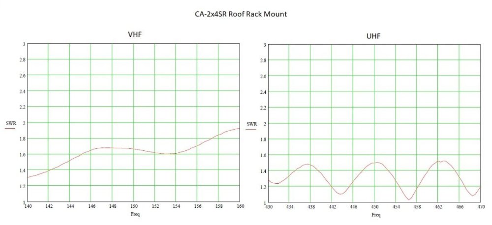

Well I got around to doing an SWR scan of both the Comet CA-2x4SR and the Diamond NR240CA wide-band antennas the past few days. Both were tested on the UHF type roof rack mount I have on my Mazda. Both antennas are 5/8 wave design, thus they need a decent ground plane to work. I expected crummy results. However I'm absolutely shocked how well they matched up on the VHF and UHF bands!!! I guess there is enough "ground plane" under the mount, plus whatever capacitive coupling between the mounting strap and roof rack rail for a better coupling to the rack rail. The installation looks like this photo, but I have a different antenna on the mount at the time.
 https://forums.mygmrs.com/gallery/image/471-mobile-mount-with-antenna-rear-view/?context=new
The attached photos show the match on the VHF and UHF bands. The results are very similar. Not uprising since both designs look about the same except the center loading coil. subjectively I think the Diamond antenna match is a bit better.
