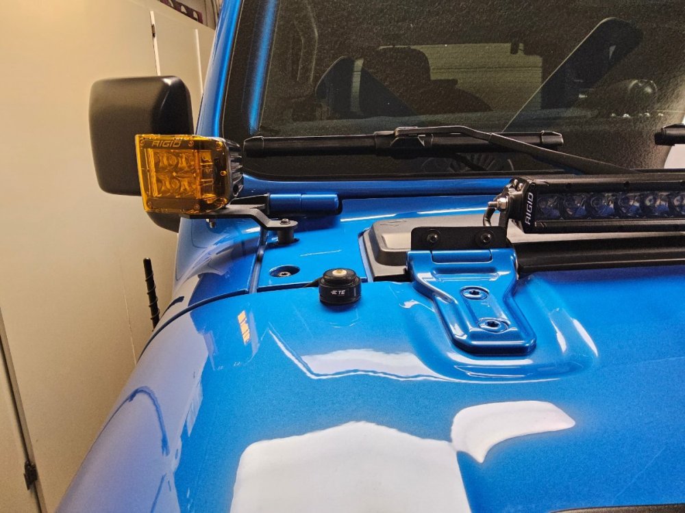

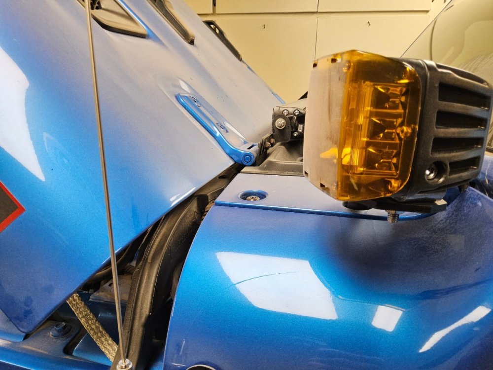

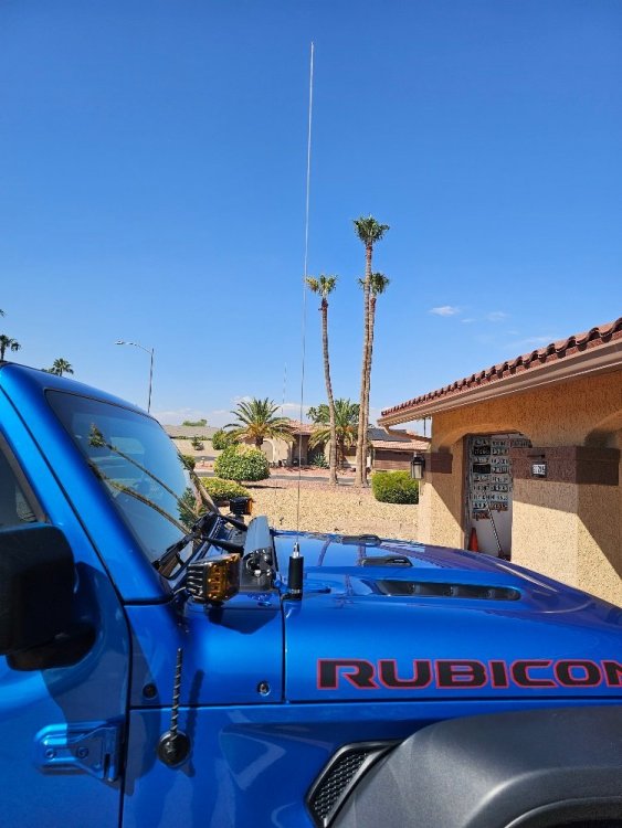

nokones Posted October 17, 2024 Report Posted October 17, 2024 After posting my test results on the performance/evaluation of the Firestik II antennae about 2-3 weeks ago, and of course there were forum members that said the Firestik II antennae where one of the worst antennae and the placement of the antenna on my Dutch-Corporation Owned American made Non Asian Wrangler Rubi was also one of the worst locations, and that I should be using a NMO Trunk Lip Mount clipped to the rear edge of the Hood at the cowl, and a C27 base load antenna, for better performance results in the Farz. Well, I decided to bite into that carrot and I purchased two Antenna Specialist/Antenex/Laird/T E Connectivity C27 Base Load antennae and the NMO Trunk Lip-Mount and I conducted my Farz test today identical to the test as I did with the two Firestiks. I ran the same route and used the test point locations. The transmitting and the receiving vehicles, radios, noise floor level were identical, as the previous test. The C27 antennae were tuned and the VSWRs were in the very low 1's. Today's results revealed that the Firestik II antenna outperformed the C27 base load antennas. Just to recap the test with the Firestiks, I was able to have readable communication at 2.25 miles in the AM mode and 3.25 miles in the FM mode. With the C27 antennae, the AM mode revealed readable communication up to the 1.25 miles and the FM mode revealed readable communication up to 2.5 miles. Guess what my Jeep Creep friends, I will be using the following antenna for my CB Radio communications: because this did not work to be the best: SteveShannon and WRXB215 1 1 Quote
Guest Posted October 17, 2024 Report Posted October 17, 2024 In ye old days, Firesticks always out performed base loaded antennas. Sure, you can mount one in a bad place and they do poorly but location for location, anywhere on the vehicle a Firestick would always do better than a base loaded coil. Best location of all time was smack-dab in the center of the roof of my Suburban. The young do stupid things. : ) This comes from doing "CB" in the 1970's and later again (I apparently can't learn better) in the 80's. I admit, I had forgotten about the Firestick things for a very long time. That light bar may be too close to the base load. Quote
nokones Posted October 18, 2024 Report Posted October 18, 2024 1 hour ago, WRKW566 said: In ye old days, Firesticks always out performed base loaded antennas. Sure, you can mount one in a bad place and they do poorly but location for location, anywhere on the vehicle a Firestick would always do better than a base loaded coil. Best location of all time was smack-dab in the center of the roof of my Suburban. The young do stupid things. : ) This comes from doing "CB" in the 1970's and later again (I apparently can't learn better) in the 80's. I admit, I had forgotten about the Firestick things for a very long time. That light bar may be too close to the base load. Yah, the NMO mount could be too close to the light bar. But it doesn't matter anymore. The Jeep is a poor radio antenna platform. SteveShannon 1 Quote
Guest Posted October 18, 2024 Report Posted October 18, 2024 That sir, is a great picture! And from that angle, the base load was no where near that light bar. Shows how little time I have spent looking at Jeeps. It is clear in the first image that the mount is outboard of the hood hinge and the light bar is inboard. Plenty of room there. (good brand of light bar too!) Quote

WRXB215 Posted October 18, 2024 Report Posted October 18, 2024 I know LEDs are a source of RFI but I'm pretty sure @nokones didn't have them turned on during his test. So, as far as I'm concerned, the test is still valid and the Firestick wins. Good info. I haven't bought a CB yet but I keep circling back around to the idea. If I ever do, I will likely get a Firestick for it. Quote
nokones Posted October 18, 2024 Report Posted October 18, 2024 31 minutes ago, WRXB215 said: I know LEDs are a source of RFI but I'm pretty sure @nokones didn't have them turned on during his test. So, as far as I'm concerned, the test is still valid and the Firestick wins. Good info. I haven't bought a CB yet but I keep circling back around to the idea. If I ever do, I will likely get a Firestick for it. No, the Lightbar wasn't turned on because I had to reason to light up the roadway during the day and the light bar would not have had any affect doing so. Quote
