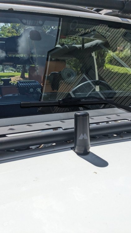

So it has been a bit since I was on here and I can say I got a good amount of responses. That said the first one was a bit hilarious. I have a feeling that marc has not looked at the antennas mentioned let alone the antennas that the Australians use for those CB Radios.
With that all said I found out that the Ghost Antenna is not meant for much if it isn't grounded well. That was something I found out recently from Midland. Because of that I decided to go ahead and purchase the Highland antenna. Why? Because that antenna does not require a Ground Plane. Because of that I should technically get better performance causing me to get better range(within reason).
Now for those wondering why a 3dB antenna has been chosen over other antennas, I understand my particular use. I don't necessarily need to talk to the moon, but I know that a good antenna paired with a good radio you can get an excellent range in multiple terrains allowing you to speak to others and get weather information from NOAA(if there is a tower nearby).
The antenna was just ordered today and I am looking to get it installed in the next weekend. Once that happens I will test the performance and report back.
Midland calls it a ghost, others call it a 'phantom' antenna. There are ground plane kits for it, nmo mount with radials. Works nicely for wall or mast mounting. Myself if I decide to mount using the ground plane kit, I go with a 3 db stainless whip. Little more to capture signals.

I mounted mine with a Midland – MXTA27 MicroMobile Universal Lip Mount. It seems to use the ground plane of the hood well enough. I'm able to hit a repeater 40+ miles away from me with ease. It's not as clear as on my home base station using an Ed Fong J pole, but it does well enough and for jeep to jeep comms under 3 miles, it's like the person is sitting in the Jeep next to me.
From what I can tell here, you have a little bit better setup than me with that antenna. To specify it comes down to having a ground plane of sorts. I myself do not have that with my antenna. It doesn't help either that I have a few other items nearby the antenna causing some interference as well.
In reality it all depends on the setup. For myself I find that I will need  a different antenna that isn't as dependant on a ground plane. That will be the advantage of the Highland antenna since it is more ground independent.
