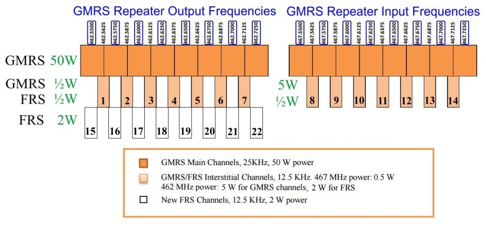

AdmiralCochrane Posted January 8 Report Posted January 8 onemanparty, SteveShannon, H8SPVMT and 4 others 4 3 Quote

MarkInTampa Posted January 9 Report Posted January 9 On 1/7/2025 at 8:31 PM, AdmiralCochrane said: I'm stealing this chart. It's the first time I've seen the frequencies laid out this way, pretty cool. WSGL775 1 Quote
nokones Posted January 9 Report Posted January 9 On 1/7/2025 at 6:31 PM, AdmiralCochrane said: 99 This chart is inaccurate and is mostly confusing and contrary to the rules in Parts 95.567 and 95.1767 in respect to RF output power levels for both the FRS and GMRS radio services. The rules state that Channels 1-7 are regulated to 2 watts ERP for non-licensed FRS service and 5 watts ERP for licensed GMRS service. The left chart indicates channels 1-7 for both FRS & GMRS are regulated to a .5 watt and that is incorrect. The right chart indicates that Channels 8-14 are regulated to .5 watt ERP for FRS and that is correct, and 5 watts for GMRS and that is incorrect, all transmitter transmitting on these channels are regulated to a .5 watt ERP, regardless of the two radio services. The left chart indicates that channels 15-22 are regulated to 2 watts ERP and that is correct. Both charts indicates that the 462 (462.550, 462.575, 462.600, 462.625, 462.650, 462.675, 462.700, and 462.725) and 467 (467.550, 467.575, 467.600, 467.625, 467.650, 467.675, 467.700, and 467.725) Main Channels are regulated to 50 watts and that is correct, except for the 467 main channels, they are regulated to 15 watts for fixed class station operations. The 50-watt output is not limited to the measurement of antenna ERP for the 462 & 467 main channels. The 50-watt output limit is the measurement of power out of the transmitter before the antenna and there is no limit of the ERP of the antenna. Lscott, H8SPVMT, WSGL775 and 3 others 5 1 Quote

MarkInTampa Posted January 9 Report Posted January 9 6 hours ago, nokones said: This chart is inaccurate and is mostly confusing and contrary to the rules in Parts 95.567 and 95.1767 in respect to RF output power levels for both the FRS and GMRS radio services. The rules state that Channels 1-7 are regulated to 2 watts ERP for non-licensed FRS service and 5 watts ERP for licensed GMRS service. The left chart indicates channels 1-7 for both FRS & GMRS are regulated to a .5 watt and that is incorrect. The right chart indicates that Channels 8-14 are regulated to .5 watt ERP for FRS and that is correct, and 5 watts for GMRS and that is incorrect, all transmitter transmitting on these channels are regulated to a .5 watt ERP, regardless of the two radio services. The left chart indicates that channels 15-22 are regulated to 2 watts ERP and that is correct. Both charts indicates that the 462 (462.550, 462.575, 462.600, 462.625, 462.650, 462.675, 462.700, and 462.725) and 467 (467.550, 467.575, 467.600, 467.625, 467.650, 467.675, 467.700, and 467.725) Main Channels are regulated to 50 watts and that is correct, except for the 467 main channels, they are regulated to 15 watts for fixed class station operations. The 50-watt output is not limited to the measurement of antenna ERP for the 462 & 467 main channels. The 50-watt output limit is the measurement of power out of the transmitter before the antenna and there is no limit of the ERP of the antenna. I like the chart for how is visually displays the channels and frequencies, didn't even look (or care) about the power limit thing. I've got a similar chart for shipboard communications in kind of the same format, it's just the first one I've seen for GMRS. SteveShannon, WRUU653, Lscott and 1 other 4 Quote

WRYZ926 Posted January 11 Report Posted January 11 9 hours ago, WRYS709 said: I have my Yaesu FT-857d, so I am well aware of the shack in the box, but none of the truly portable ones are manufactured anymore. So there is nothing I can recommend. But I have my Radioddity DB20-G and I purchased a Quansheng UV-K5(8) and flashed the IJV3 Firmware and now for $20 I have a 2 meter/440 DSB HT that is compatible with SSB. I made a 65 mile contact with my legacy AEA 5/8 telescoping antenna on 2 meters SSB. It really is a shame that no one makes a mobile radio with those features anymore. I have a Quansheng UV-K5 (8) that I installed IJV3 on but I haven't tried the DSB mode yet. I doubt that I will add the extra board for HF though. On subject. As the photos and graphs show, channels 8-14 are in-between the repeater input channels and that is why 8-14 are limited to 0.5 watts. Though my testing has shown that transmitting on channels 8-14 at 4 watts did not cause any issues when I had my base radio on a repeater channel and also on simplex listening on the repeater input frequency. I tested with an unlocked HT set to both narrow and wide band and high power which was 4 watts. I would not suggest doing that with an unlocked radio set at 20 watts or higher. And we have to stick with the designated channels for GMRS since their are other users near the same frequencies that we do not want to interfere with. Quote
