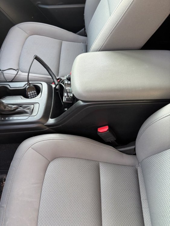

SvenMarbles Posted January 11 Report Posted January 11 I've been operating with a Radioddity DB20G in my truck since Christmas. I wasn't planning to make a fuss over it or type up a review or anything, because I felt like it was a pretty basic, standard, inexpensive, knock around mini-mobile GMRS radio. But after using it for these weeks, I've noticed that I just really like this radio a lot. It does all of the small things right. It may sound silly to some, but I just really appreciate that it uses a big switch on/off volume knob. For a radio that I operate in a vehicle, I appreciate it when a radio isn't "fiddly". I reach over blind, switch it on and set to a comfortable volume in one intuitive and effortless motion. The radio sits in a spot that is absolutely perfect in my truck (pictured in following post). Facing face-up below where my right arm would rest on the middle console. The speaker is powerful and can be cranked up adequately loud to hear comfortably above road noise. I also appreciate that this radio is 20 watts (and actually is) which means that it can safely be powered by a cigarette lighter plug. When you power on/unlock the radio, you have full freedom to program as many simplex and repeater channels as you'd like. I used the included bracket and some 3M hook and loop strips to make it so that I can simply pull the entire radio off to bring it inside for programming, or use it in another application. Reception is great, no breakthrough overload, and reports are that I sound nice talking on it as well. It just hits the sweet spot of preferences for me in a radio for how I want to be able to use a radio.. amaff, SteveShannon, Bobuff977 and 2 others 3 2 Quote

tcp2525 Posted January 11 Report Posted January 11 1 hour ago, SvenMarbles said: I've been operating with a Radioddity DB20G in my truck since Christmas. I wasn't planning to make a fuss over it or type up a review or anything, because I felt like it was a pretty basic, standard, inexpensive, knock around mini-mobile GMRS radio. But after using it for these weeks, I've noticed that I just really like this radio a lot. It does all of the small things right. It may sound silly to some, but I just really appreciate that it uses a big switch on/off volume knob. For a radio that I operate in a vehicle, I appreciate it when a radio isn't "fiddly". I reach over blind, switch it on and set to a comfortable volume in one intuitive and effortless motion. The radio sits in a spot that is absolutely perfect in my truck (pictured in following post). Facing face-up below where my right arm would rest on the middle console. The speaker is powerful and can be cranked up adequately loud to hear comfortably above road noise. I also appreciate that this radio is 20 watts (and actually is) which means that it can safely be powered by a cigarette lighter plug. When you power on/unlock the radio, you have full freedom to program as many simplex and repeater channels as you'd like. I used the included bracket and some 3M hook and loop strips to make it so that I can simply pull the entire radio off to bring it inside for programming, or use it in another application. Reception is great, no breakthrough overload, and reports are that I sound nice talking on it as well. It just hits the sweet spot of preferences for me in a radio for how I want to be able to use a radio.. Yep, this is probably the best less than $100 mobile rig on the market. It's very well built and virtually indestructible. The PA protection circuitry will throttle output power down as radio heats up or SWR is not ideal. You'll never find a DB20 with fried finals. amaff 1 Quote

SvenMarbles Posted January 11 Author Report Posted January 11 2 hours ago, WRYS709 said: Is there a better one for $200? $300? I mean.. It's a loaded question. I don't own "all of the radios" so I can't say for sure. Rubicon probably does lol. But what is "better" anyway? Specs? We're not supposed to be a nerd band theoretically. But I know that a lot of us are. So maybe you care about if the receiver is a superhet receiver. BUT, how does that weigh against the functional advantages of the radio I'm reviewing in this post? Size, the user interface, power draw, etc.. Maybe I can make the argument that this radio is "better" because those are the factors that matter to me for my use case.. WRUU653 1 Quote
