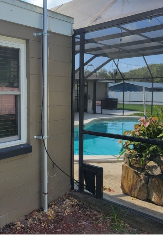

I'm running a 30ft flag pole from Home Depot for a mast with a GP-6NC. For a bit more stability it's also anchored to the house. I ordered a telescoping flag pole but they sent me a sleeved sectional (6 5ft 2-1/4" sections) by mistake. Didn't send it back, figured it would be more solid than the telescoping version and by loosening the clamps on the house I can remove or add sections by myself so it wasn't a big deal. I thought I could get away with no guy wires but it seemed to sway a bit more than I would like at 30ft so added some. Dropped it to 10ft or so with the antenna attached and it made it through a direct hit from hurricane Milton.
