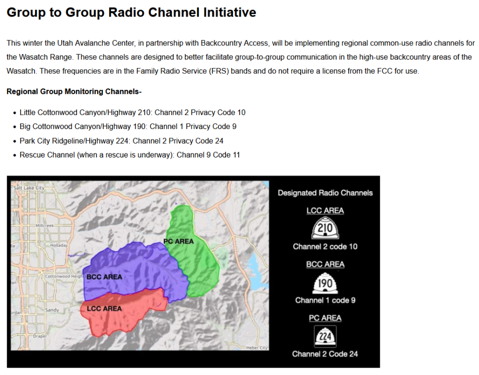

amaff Posted July 6, 2024 Report Posted July 6, 2024 The Utah Avalanche Center did something out here for the Wasatch mountains this year. I really wish it was just 1 unified way of doing it instead of peace meal (and extremely local...having 1 statewide way to reach help, potentially, seems a lot better than a bunch of different once depending on where you are), but I have it programmed into my radios: https://utahavalanchecenter.org/education/group-group-radio-channel-initiative WRZD727 1 Quote
BoxCar Posted July 7, 2024 Report Posted July 7, 2024 It would be better if they listed the tones used as not all radios use the same tone code scheme. SteveShannon, WRZD727, TrikeRadio and 4 others 7 Quote
amaff Posted July 7, 2024 Report Posted July 7, 2024 2 minutes ago, BoxCar said: It would be better if they listed the tones used as not all radios use the same tone code scheme. Also yes. TrikeRadio 1 Quote

amaff Posted July 7, 2024 Report Posted July 7, 2024 19 minutes ago, WRUU653 said: Absolutely or even better they shouldn’t use tones. If I am in a situation where I’m using a radio in an emergency I think I’d like to be sure anyone could hear the call. The idea that someone has to have a particular tone set for an emergency call added with the fact that one manufacturer numbers may well be different than another seems to be promoting a problematic situation. I imagine the thinking is with tones set specifically for an emergency that one only needs to monitor those transmissions but this only helps those that know and understand tones. My two cents at today’s discounted price of zero cents. When I put the Utah bunch into my hiking-backpack radio, I put them in on Tx only, so I can hear everything). 7 minutes ago, nokones said: Channel 9 is an interstitial low-powered channel that can't exceed .5 watt ERP. Using a low-powered channel in any rural back country area doesn't make any sense at all. I think that was a poor choice. I agree completely. But they didn't ask for my input when they put this together. I've sent them a message saying essentially that. So we'll see. Quote
