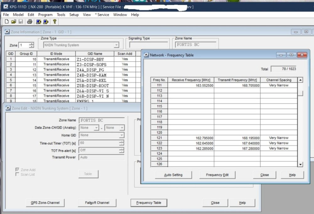

Some people have toyed with the idea of using a single frequency "trunked" repeater where every radio has to be registered with the ESN, by using the internal Electronic Serial Number, to authorized access. As far as I know there isn't a way to change the radio's ESN.
The typical analog system is known as LTR, Logical Trunked Radio, and the variation using the radio's ESN called Passport.
Some people have bumped into used radios with the special Passport firmware loaded. When they try to reprogram the radio using the "normal" software the display shows SJ-180 and fails to load the code plug. I even had a used Kenwood TK-3180 HT with that firmware loaded. I managed to load the normal LTR firmware so I could use the regular radio programming software. I do have a copy of the special SJ-180 programming software too.
This is also fairly common on digital voice mode repeaters. The process to get a radio on one of those is a bit more complex requiring a "system key" file, licenses etc. just to program the radio. Normally with those radios you can't even read the radio without the system key file. There are hacked versions of the radio programming software out there that will read the radio and save the contents as a ".srv" service file without it. See attached screen shots of a used NXDN trunked radio I read with that software.
